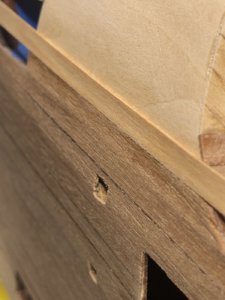

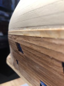

Hello
I’m having trouble with the second planking (.5mm) cupping on the model after I apply the glue and before it’s had time to set. I’ve tried wetting the wood before gluing but same results.
Any suggestions?
Thanks
@Lwood Hello! Most likely you put too much glue. Another problem is the glue itself: what kind of glue it is? Try Tilebond II or Elmer's wood glue as an alternative. Another way or I should say workaround, is to use iron. While the plank is moist and in a position, top with the iron (press). As you see glue is set, move along the plank to the end. Be careful as your Admiral might not be happy if knows you took it. But we will not tell her...;)
Thanks I’m using weldbond glue but I have tightbond as well. I’ll try it to see if it makes a difference.
Thanks
Yes, I am suggesting to switch for a different glue. Wellbond doesn't dry fast, instead, it soaks the planks. May I suggest you a Lineco brand? I have been using it in many builds with much success!
