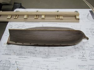

This is my first attempt at planking a ship. I have my first layer on and am thinking about putting on the second layer of walnut. I am planning to finish part of it with stain and then a clear coat. It seems to me that no matter how careful you can be you will get glue where I am planning on staining which will leave it looking blotchy looking. How do you get around that? Thanks for any help you can give.

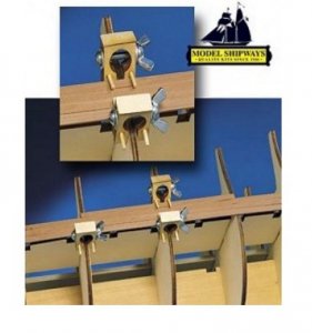

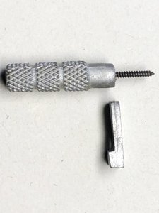

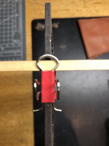

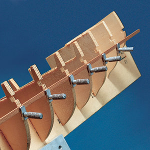

What kind of clamps do you use for this?
Hi Augustine,
Obviously, you can make your own out of paper bundles clips. But if this sound to you difficult, you can buy them. One of them is more appropriate for Plank-on-Frame (POF) construction, but you can use them on Plank-on-Bulkhead (POB) by ModelshipWays (click the link). They look like this and comes on different sizes.
The second type of clamps should be used for POB type of model. Here is the link for your information (click the link)
alternatively, for POB type build you can simply use nails (if the hull is double planking) or pushpins

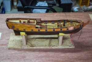

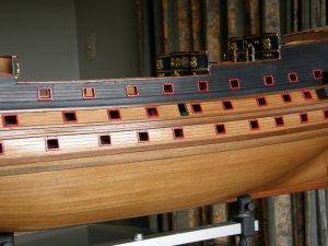

Like many have said already white glue works, however CA also works. Some tight bends will need the CA to get a hold of one end . As I have said here before I’m a stain guy, I love seeing the wood take on a natural look. I very rarely use paint, I have never used it on a hull, not everyone’s choice but it’s the way I build. For me its all about keeping the same sequence of work. For a second planking I only use .05mm strips, thin makes them easy to shape, first I soak them for about 15 min, then apply a very thin coat of glue only working a few mm ahead to get the plank bonded up tight then I apply heat to steam bend the wood into place, the glue simply bonds into the wood with stream and heat. no clamps needed. I get little to no glue push out. After a section is complete, I wipe the area down with a lightly damp cloth. Again, this is just my style IMG_1701.JPGIMG_3689.jpg

Like many have said already white glue works, however CA also works. Some tight bends will need the CA to get a hold of one end . As I have said here before I’m a stain guy, I love seeing the wood take on a natural look. I very rarely use paint, I have never used it on a hull, not everyone’s choice but it’s the way I build. For me its all about keeping the same sequence of work. For a second planking I only use .05mm strips, thin makes them easy to shape, first I soak them for about 15 min, then apply a very thin coat of glue only working a few mm ahead to get the plank bonded up tight then I apply heat to steam bend the wood into place, the glue simply bonds into the wood with stream and heat. no clamps needed. I get little to no glue push out. After a section is complete, I wipe the area down with a lightly damp cloth. Again, this is just my style View attachment 70895View attachment 70896
This sounds like a good way to do it. I’m going to try it. Thanks
