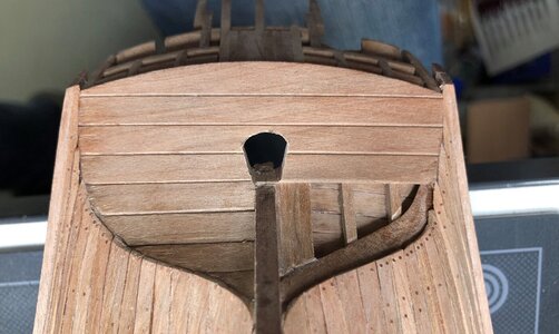

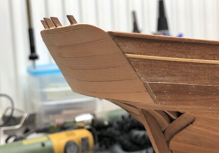

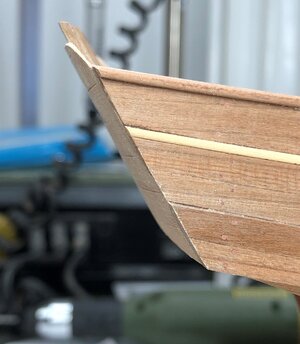

I have a question concerning planking? should the stern or transom planking overlap the hull planking or vice versa same in the forecastle area I have seen it done both ways on some builds which way is correct?
Hello Bandido, as far as I know double planking is a freedom for model makers, no boat has double planking
There is a on-going discussion about it (or better I followed already a discussion in the past)
In my opinion the hull planking is overlapping the transom planking

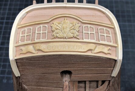

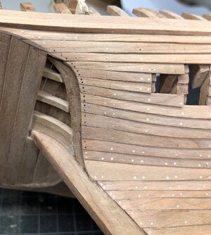

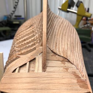

Here some photos on my Le Coureur
also confirming this is the photo of this "real" wooden ship
On historic ships the ending of the hull planking are covered with a ornament or a finishing rail or taffarel.
This was helping to protect against rot

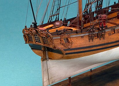

This is a contemporary model of the HMS Speedwell, model built in 1752
It is visible, that the wales and side hull planking extended aft and past the planks of the counter

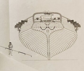

also Jean Boudriot is showing it in the same way in his plansets, here f.e. the Le Cerf
Hi Uwek, are you replying to me or others? I understood is answered on the double planking to Bandido
I agree hull planking overlaps stern planking. To do the opposite also looks wrong!
