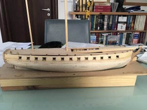

Hi all, please forgive me if this is posted in the incorrect place; having sanded down the first layer of planking , my question is, is there a procedure to prepare the sanded planking to receive the second layer, such as , leaving a sanded finish, a coat of , perhaps, sanding sealer etc, will such a coat impair the. adhesion of the second planking layer?. My base layer is of Lime boards approx 5 mm wide, the second will be a hardwood of 3 mm x 1 mm , a smaller plank no doubt S little easier to apply???.
Further to the above, is there a preferred adhesive, I.e. PVU, epoxy two part, or some other universally available type.
Thanks guys.
Hi Chris no,leave as it is,it will cause issues with gluing.Only apply sealer/finish when the second layer is on Thumbsup
Kind Regards
Nigel
Hi Nigel,
Many thanks , that’s how I had thought, but being the first I thought to ask out. Just about to attempt the first two sets of rubbing strakes in prep for the second stage planking.
Kind regards and have a good weekend. Chris S
Glue choice is very polarizing in that modellers have there own preferences.Cyanoacrylate PVA or contact adhesive are suitable.Epoxy will stick it but it will be a nightmare to work with as it has no grab properties,you would have to clamp every plank fully and solidly while the Epoxy set.
Kind Regards
Nigel
Thanks again Nigel
