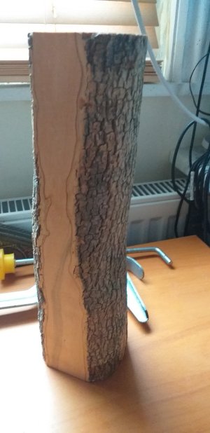

More excitingly I now have a supply of genuine English boxwood (Buxus Sempervirens). An acquantance from my piano technical work has some pieces up to 5'' in diameter and 12'' long!! I have a small sample to test out and it looks promising. I realise there'll be a lot of waste material, but as I'll be working at a small scale I can be a bit more efficient in milling the lumber............................
I did a search on-line for hardwood in England and the returned info is shocking. I am not sure if your hardwood lumber yards are selling wood or platinum. For a first scratch POF, I would use a hardwood species that is easily obtained. Based on what I guess is available I would use Maple (Sycamore - (Acer pseudoplatanus)) or Beech or Birch. I would want to see the grain on the last two. I would never use something as rare and dear as Buxus for framing - the loss to sawdust is just too great. The cost to benefit equation does not support using Buxus for large volume structural elements. For carving and deck structures it cannot be exceeded.

You raise a good point. I wouldn't want to disrespect such a rare material. The waste I mention above is largely because of the quality of the colour variation and overall quality of the material.
I'm only considering a 1:96 cross section of Granado based on the plans drawn by Jeff Staudt, so very little material required in total.
The frames will be built from individual futtocks, so minimal waste there. Having said that I did see some cut through logs of the Buxus and they were shot with discolourations, splits and bacterial damage, so there are only quite small usable areas anyway. I can easily obtain very large boards of highly consistent Castello for the floor timbers, lower futtocks, riders and magazine structure, which are the thickest and strongest members.
Ditto to what Jaager said regarding the use of boxwood. Boxwood's greatest value is as a carving wood. There are other far less expensive and scarce species which will provide a better appearance if left bright and if they will be painted or stained, there's no difference either way. I'd add swiss pear and cherry to the list of alternate species to consider.

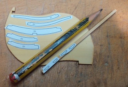

So.....I've prepared a 1:96 Granado frame ready for cutting out when it has dried sufficiently. The trusty fret saw, and the usual files, will be my weapons of choice.
I'm using high-quality Chinese buxus for the frame, and same quality brown Buxus for the chocks in order to create contrast and see the elements more clearly.
I haven't decided whether to make simple isocoles chocks or whether I'll go with the Jeff Staudt's plan and use the stylised chock and scarf method. Hopefully the later.1761823317125.png...........................
