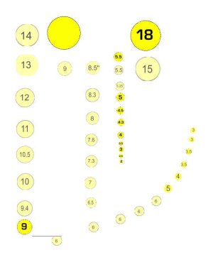

On a new layer I used the lasso selector to form a circle over the ruler layer that is 12" in diameter. This was tricky because the lasso will be an oval if you let it.
Once it was a circle - I filled it with the brightest yellow I could conger up.
On a different layer I typed a black "12" with a font and point size that fit inside the yellow disk. I combined a copy of the yellow disk and the "12" on top into a single layer. I named the layer 12.
Two choices:
Use the lasso and do the work to get a perfect circle with every other diameter that might be needed.
Scale up or down a copy of the 12" disk. Each with its dia. ID.
Here is a copy of my moulds.rif file with all of the disk layers. I played with the lasso and a black background layer to get a black rim. More work but it helps old eyes - especially at the time before my cloudy cataracts were replaced.
This was no fun to do. I do not wish to do it again. I keep copies of the group folder with all of the separate disk diameters on several HD.

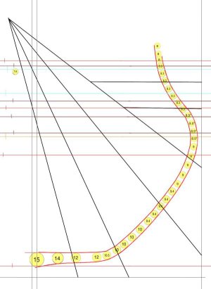

I slide a disk until it just kisses the frame line inside.
I place all of the knowns.
I fill the in between with disk diameters to get a smooth curve . I usually replicate the big one almost all of the way and then a few that diminish/transition to the next known.
Once the deadflat mould shape group folder is complete, move a copy to the bottom of the line list - I call these tools "storage".
Move another copy of the group to the next frame in line. It is easier to just side a disk a little ways. Drop disks when things get crowded towards the bow and the stern.
I have near shoulder to shoulder disks from keel to rail, on a new layer I use the straight line drawing tool to connect the dots at the tangent point of every disk. (I use a 2 pixel line and the cursor circle at ~1 o-clock is a tangent)
Collapse the deadflat group to a single layer "Molds" - unless your program still plays nice when a file gets huge. Painter does not like it when file size exceeds its limit.
This is a series of line segments - of facets - and not a beautiful smooth curve. If the facets are short and all is close to being a curve I find it impossible to get anything but a smooth curve on the wood that it is the pattern for.

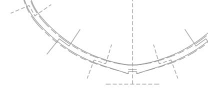

I recommend against replicating the blue diagram F1 to F1 design. I believe that the F1 to F1 cross chock over the keel a much more substantial. A heel to heel butt joint at the center of the keel was a weak point and was essentially forbidden. There were 3 choices that I have seen:
a half floor (a timber over the keel that is one half the length of the floor - (I use for US 19thC. and French vessels)
a long arm F1 crossing the keel meeting a short arm F1 a ways away from the keel ( mid 19thC. merchant) whether it was PORT F1 long or STB F1 long was alternated along the keel.
A substantial cross chock. It was likely most often a mini half floor with the scarph to F1 a ways beyond the keel.
I have never seen it precisely defined but I take it that the "cutting down" was at the vertical line at the outside edge of the keel.
