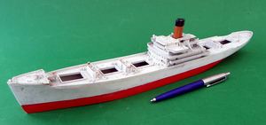

Here are a Liberty, and a Victory. The liberty (top) is one I built - the plastic one is a kit -
Bob

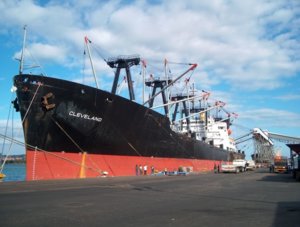

I used to sail a C5-s-75a, the last of the old American C-series break bulkers. A real Cadillac of cargo ships. This was the S.S Cleveland, formerly the S.S President Cleveland, and before that built in 1969 as the S.S. American Mail. Five hatches, a cruising speed of 17 knots, 12 passengers, steam turbine driven. I was her Engine Cadet Midshipman in 1985, then later her Second Engineering Officer. Somewhere I have copies of the General Arrangement blueprints. No scantlings diagrams, but dozens of photos of the entire vessel. She was scrapped in 1996. Of all the ships I've sailed, she was my absolute favorite. Having just gotten off a modern supertanker, the S.S. Exxon Benicia, boarding the President Cleveland was like going back in time, from a modern super tanker back to the 1940's. It felt like I was in a Humphrey Bogart movie. Maybe someday I'll make model of her. I take it you went to Mass Maritime, Christine?

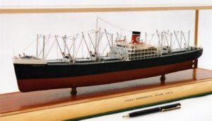

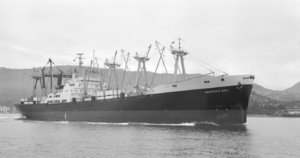

My first ship was a C3 in 1961 - Very basic and uncomfortable. We didn't even have running water in our cabins, and everything was made of steel, even the cabin furnishings - Bob

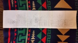

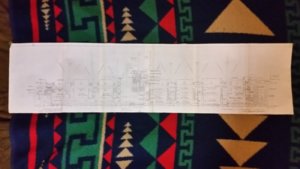

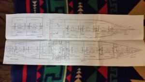

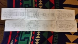

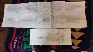

I found the blueprints from the S.S. President Cleveland (S.S. American Mail). The pictures below are not sufficient for modeling, but I can go to Kinko's Copy store and make high resolution scans some time. The paper is a bunch of 8-1/2"x11" sheets held together with scotch tape, now over 35 years old, so they are delicate. Send me your email address. I have no if scanned files will be small enough to email, but we'll see.
Lower decks and double bottom levels.
Weather Deck, house, hatches, and winch houses. Shows location of all deck equipment.
Orlop and lower decks,
General Arrangement blueprint.

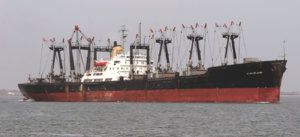

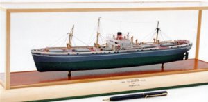

Original picture as built, the S.S. American Mail.
The last time I sailed her, she was the S.S. Cleveland, owned by Sealift Inc.

Hi Christine,
