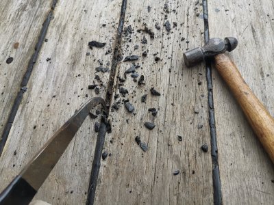

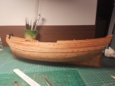

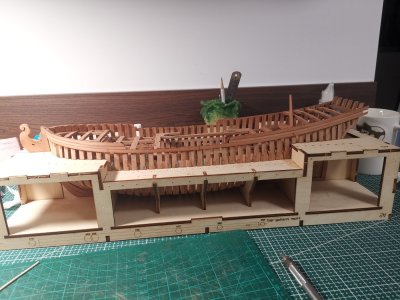

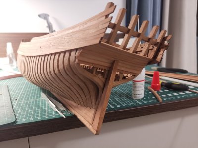

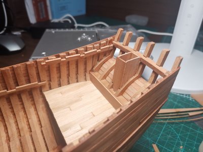

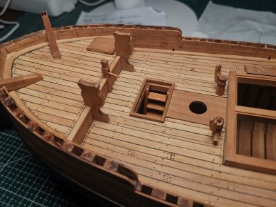

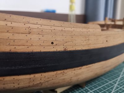

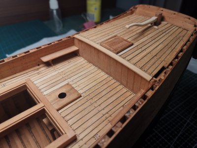

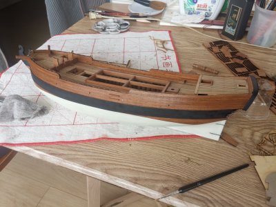

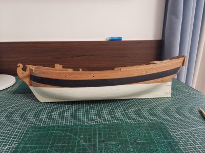

Hi folks, just a quick update on my build.

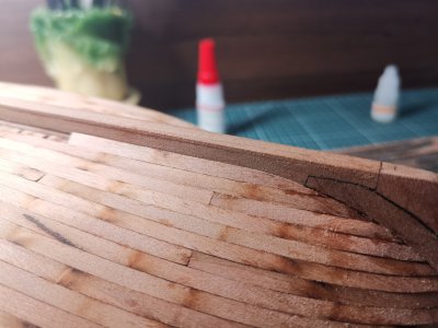

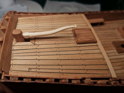

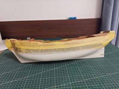

Spent about a month of spare time working on the treenails. Above waterline only
,cuz I will white the hull. This time I experimented with some new stuff—colored nylon fishing lines (brown and black), 0.4mm size—used brown for the hull and black for the deck. I have to say they are very cost-effectiveness.
Swapping out the shiny copper wire solved one problem but created another: the nylon is pretty soft, so it doesn’t slide into 0.4mm holes easily. I had to drill with 0.45–0.5mm bits and fix them with super glue, which took ages.
Still, I think the end result looks pretty decent. Next time I’ll give some other materials a try.
I am not a fan of cherry wood at all. It’s already starting to oxidize and change color, looks like a model tank finished with pigment
, which kind of forced my hand—I would had to use hardwax Oil or shellac at the finishing stage just to even out the tone.
