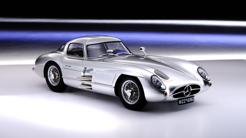

There is also a Final Edition of the Panigale coming Summer of 2021. I have reserved it, the F2 and also a LeGrand Mercedes 300 SLR from ScaleAutoWorks.com

Here some links for the MB 300 SLR:
Youtube: -> Legrand 300 SLR <-
The Mercedes SLR Uhlenhaut is from company LeGrand, part of Lemke from Germany
Looks like a very interesting kit.....
Hi Uwe,
They have been working on the development for over a year and I have been looking the site from the beginning. The possible price has already gone up in that time.;)
