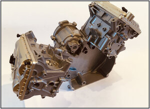

Construction can really begin now.
First a cylinder with 2 bolts from the Hardware Set (left) and 2 from the Pocher KIT (right)
Those last two are going out again.
The reclining and the standing cylinder on a piece of the sump:
Some parts for the left:
And that merged again:

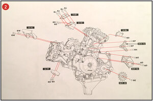

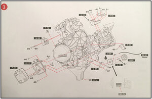

Chapter 2 and 3:

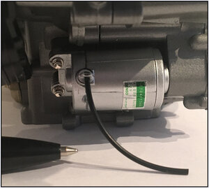

The dynamo is also in place, with its decal, applied to thickened alu-foil from the Hardware-kit :

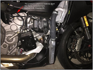

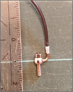

The 2nd is a banjo plug for the oil tube with the oil pressure switch.
From Paul Koo's manual:

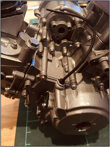

For that, Paul put some extra parts in his kit. With some self-made parts:
-a small metal bead
-flatten on two sides
-pierce hole up to 2mm
-2mm hex-bolt through it
-1mm transverse drills
-bend piece of copper wire and glue/solder into the 1mm hole. I glue it with CA
pipe
-a cable socket making of 2 pieces of alu-foil
2mm hole where the tube should go and secure the hex bolt.
Confirmed in the block:
The pipe now points to the right, but thus comes diagonally to the top left.

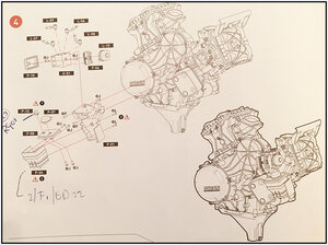

Chapter 4:
From now on I only show the drawing of the chapter on which all the individual parts can be seen.
With the composite parts.
In this chapter some parts for the canister filter and the ABS unit on the right side of the block:

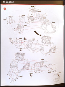

Chapter 5:

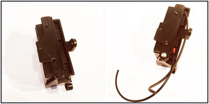

Kick stand switch

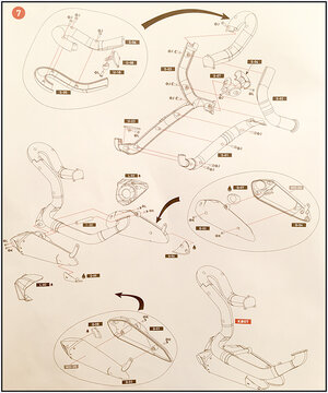

Chapter 7:
Exhaust system:
The different main components: the exhaust pipe and the two mufflers:

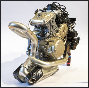

Chapter 8:

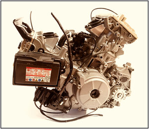

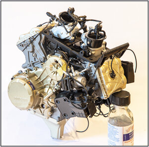

The exhaust system attached to the block. The engine is now complete.
Seen from the 4 angles:
And the 2 sides:

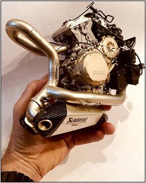

And the 2 sides:
Very impressive! If I was into bikes I would want one!
How long is the engine?
Ted
