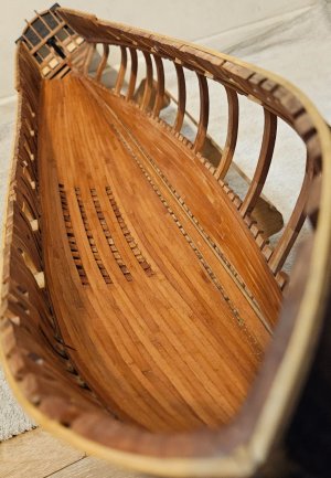

Hello dear friends

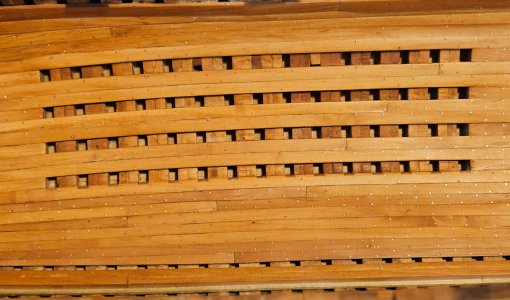

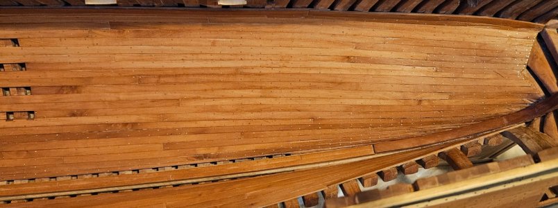

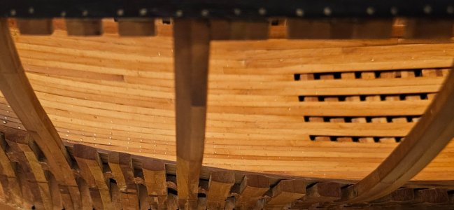

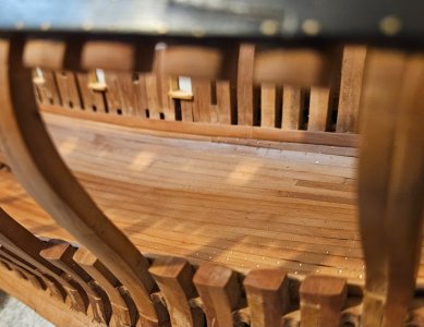

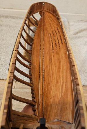

It's have been a few weeks since my last update, these weeks were dedicated to creating the inner planking of the ship's side.
Today I finished installing the inner part of the ship's deck.
Next week I will install the brass nails.
I would like to wish you all a happy and sweet New Year's Eve starting tonight.
I wish us all a year of happiness, joy, success, peace and tranquility.
May we continue to be friends and enjoy our special hobby
View attachment 546153View attachment 546154View attachment 546155View attachment 546156View attachment 546157View attachment 546158View attachment 546159View attachment 546160

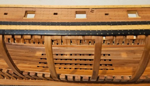

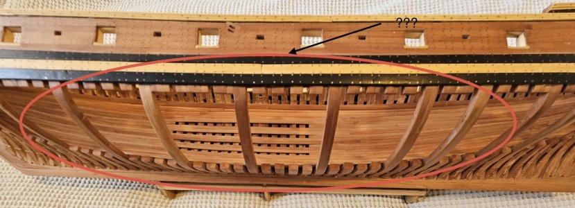

Consider me utterly confused; I completely missed that you just cut away a large amount of frames!
I'm wondering if a ship's hull is covered on one side and has holes on the other, there's a high risk of deflection along the keel line due to the difference in the amount of wood and its reaction to changes in humidity... How do you combat this?
Dear serikoff
I agree that this is a significant challenge that requires attention. The cutting of the frames was done at a late stage and in a way that for now I don't recognize any twitches.

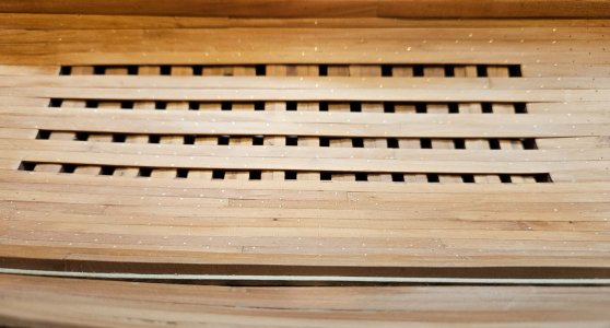

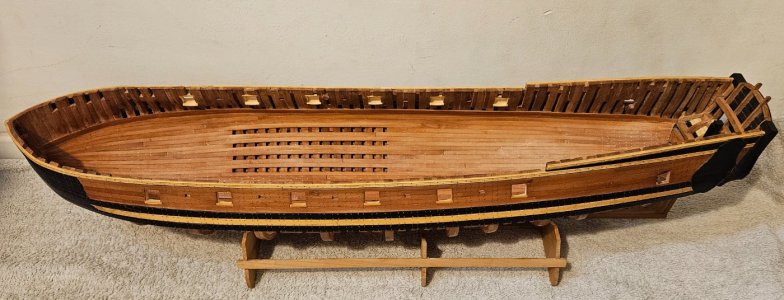

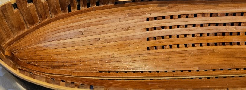

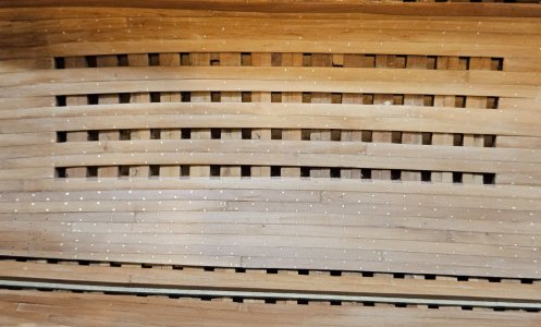

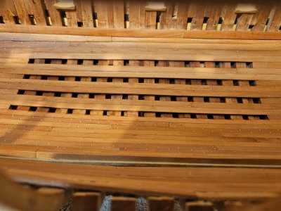

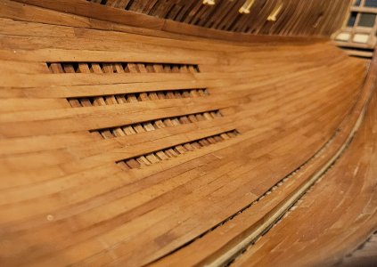

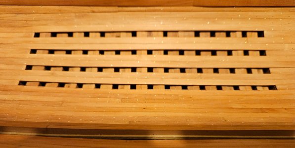

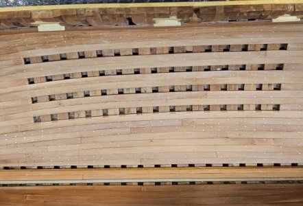

Good evening dear friends

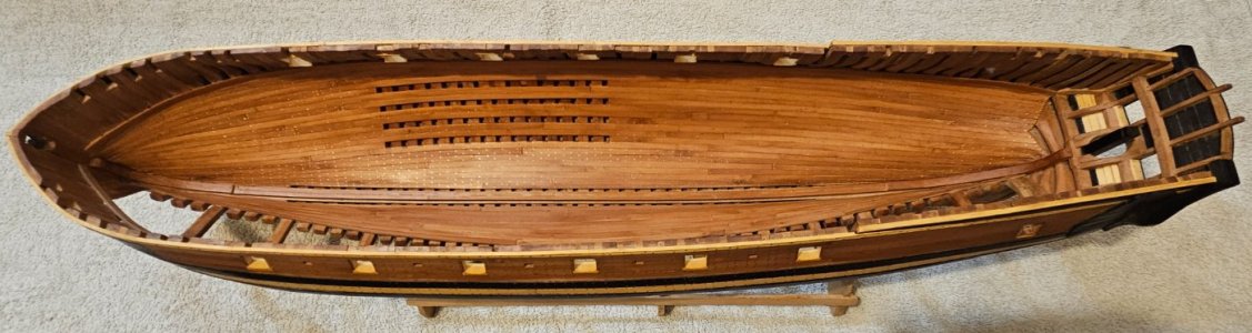

After about two and a half weeks of preparing and installing about 2500 nails, I am happy to announce that I have finished the interior planking of the lower decks of the ship.

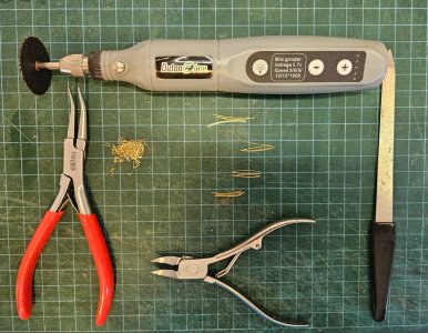

Each nail was treated individually, with an emphasis on the nail head, so that it would maintain its square structure.
Initially, I made the nails about 5 mm long, and then I would insert them each using pliers with a curved head. However, towards the end of the process, I discovered that it was more efficient to cut the square wire into sections of about 3-5 cm, then insert it into the prepared hole and cut the wire on the frame line, and then sand the end of the wire so that it maintains its square shape.
I hope the pictures faithfully reflect the beautiful result I achieved.
I wish everyone a pleasant and enjoyable weekend.
20251004_212852.jpg20251004_212911.jpg20251004_212943.jpg20251004_213030.jpg20251003_153402.jpg20251011_180438.jpg20251011_180626.jpg20251011_180705.jpg20251011_180741.jpg20251011_180810.jpg20251011_180833.jpg20251011_180953.jpg20251011_181132.jpg20251011_181107.jpg20251011_181333.jpg20251011_181443.jpg20251011_181534.jpg
View attachment 549480View attachment 549481View attachment 549482View attachment 549483View attachment 549484View attachment 549485View attachment 549486View attachment 549487View attachment 549488View attachment 549489View attachment 549490View attachment 549491View attachment 549492View attachment 549493View attachment 549494View attachment 549495View attachment 549496
What patience and dedication to make this happen, Shota. The square mails looks very nice on the prepared planks.
