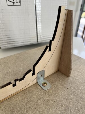

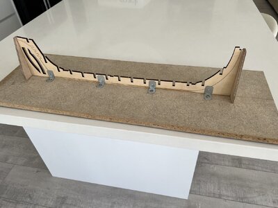

To kick things off I am making a jig to hold the keel in place while I glue in the hull frames. I used the “other side” of the keel ply (the board from which the keel was cut) as the shape to precisely support the keel. I have yet to construct the brace that will ensure the frames are fitted square and level.
Nice start. Jigs are good.
Square is good.
Looks like your workbench is too clean. Or is it the kitchen bench
Great idea to use the ply sheet excess.

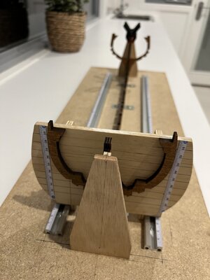

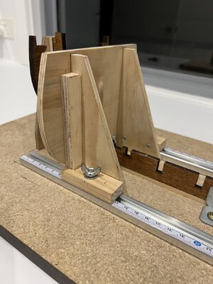

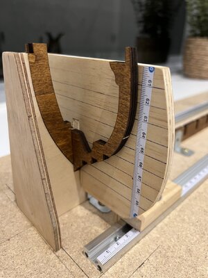

I am still fiddling around with the home-made jig to ensure the frames are glued vertical and level. I am paranoid about making sure this is done correctly, as advised on many posts. The jig is turning out fine, and looks like it will cost me about $50AUD (about $35USD). It will only be useful for the frame alignment, and I might try to adapt it to assist in holding the model while it is planked. More photos of the jig coming soon.
