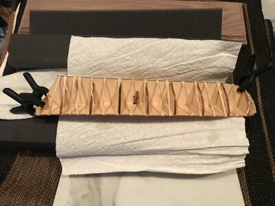

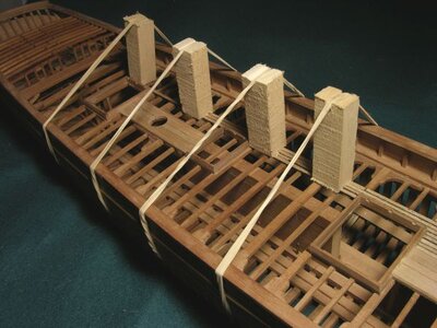

use BARB's (Big Ass Rubber Bands) ! :)
The Artesania Swift has a false deck sheet, which soiuld be planked afterwards with single planks
The idea with the rubber bands will work
8BE363CB-C936-42F0-95B1-F192389EC23E.jpeg E9ACB855-5BE2-49F1-9255-2BA4027BB261.jpeg
Take a look here how @Barry1 did it
