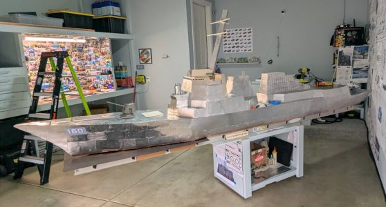

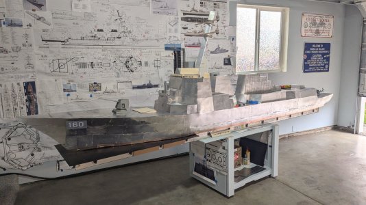

Progress report on the 1/35 scale destroyer in my garage
I like the scale a lot... however, there no way that could even fit in my working den. It is fantastic to watch though... please keep posting updates.
1/32 would have been pushing the limits of the space in my garage. Also there is a better supply of 1/35 parts, including an MH-60R.

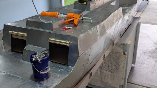

I love this model. I'd like to know how you welded the plates together and what will you use Bondo for?
The metal plating was attached to the wood with adhesive (loctite) and the bondo was to smooth out some lumps and bumps to prep for the second (and final) metal skin.
