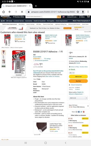

Found this stuff at AMAZON

I used this per your recommendation. I melted my styrene with it, but I think I used too much. I will try spot applications from now on. Also, this glue takes forever to set. Maybe I need to go back to contact cement, but experience shows it does not do well in heat, and may get brittle over time. I guess hide glue might be an option. Thank you for the tip.
