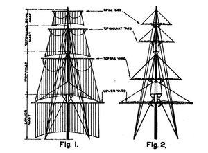

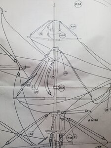

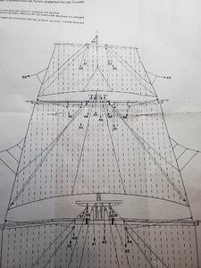

I'm confused. In Mantua's 738 HMS Victory instructions, one set of drawings show the upper two yards on all masts in a lower position but on the sail drawing, it shows them high. I plan on displaying the sails furled. Should the yard be high or low?

Sorry Kurt, but I think it is not completely correct, what you mentioned.
If the ship was in harbor and the sails are furled completely, than the yards were lowered down.
also and especially for the situation when heavy wind is expected - with this the handling is easier and the center of gravity is lower, so less movements of the ship.
The only exception is the lower yard, which will stay where it is (only during heavy weather the lowered it also - see second photo)

This is an old post but I was searching for info on where the yards were when the sails were furled so I thought I would put my question here. On figure 2 in Uwe's post it shows the topsail and royal yards as being right down on the top below but the topgallant yard only seems to be about halfway down to the top. Is there a reason for this or is just an artists thing?
