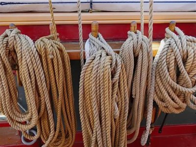

I find a light coat of dilute PVA works well. It soaks in and does not form a glue film. I also think it depends on the material your ropes are made of. I owls not saturate the ropes.

Ultra blond shellac works well as it won't have much, if any, effect on the color of the rope as described above. An alternative that is matte medium. Another alternative is white PVA diluted with water.

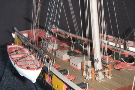

Of course both work, but I am finding the shellac drapes the line and tacks better than the many dilutions of PVA glue I've been trying to use. I like the idea of clarifying the shellac in the sunlight. As long as it doesn't turn to honey in the Southern California sun.
I wonder if there isnt a way to make our small dia ropes so that they arent stiff ... so that they drape naturally ... my larger ropes (1mm or larger) drape a bit. Some way to scale down the fibers used in winding the ropes?

Quite so. Many use diluted PVA, I suppose because it's conveniently at hand. Between the three alternatives, however, neither of the other two can hold a candle to shellac in terms of its reversibility, which is an essential feature for any conservator or restorer who may later encounter the model.
