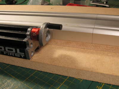

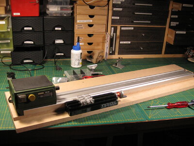

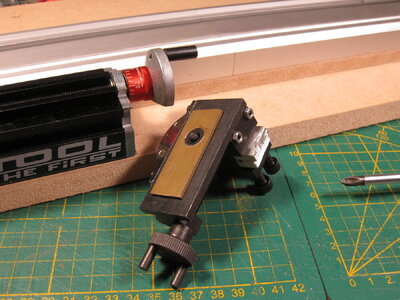

I already lengthened the lathe by installing an extra ground plate and now I installed the precision XY table.

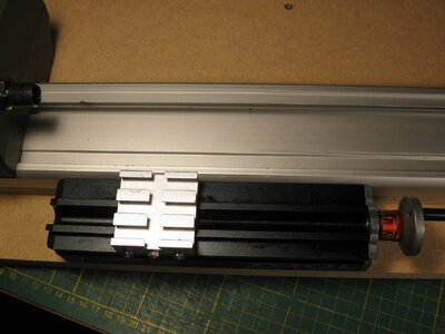

Extra brass plate to get a better fix to the table

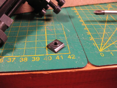

needed to adjust the nut to fit in the slider

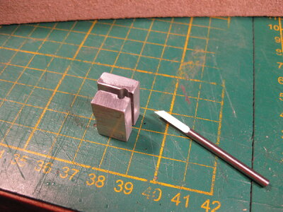

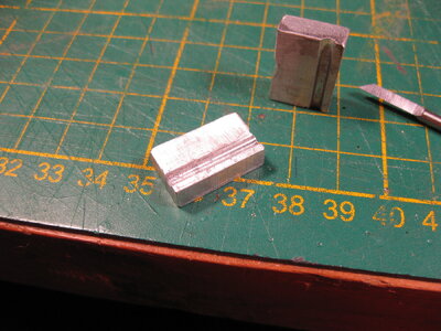

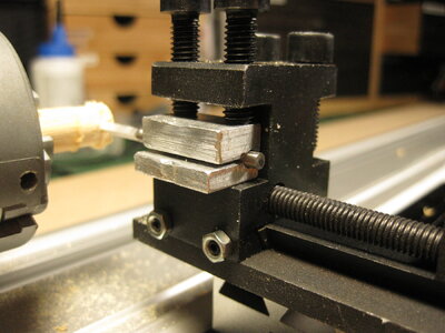

Made a small tool holder for my 3 mm chisels

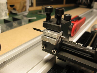

Adjusted the toolholder by 2 mm. To make sure the chisel ends in the middle of the object to turn.

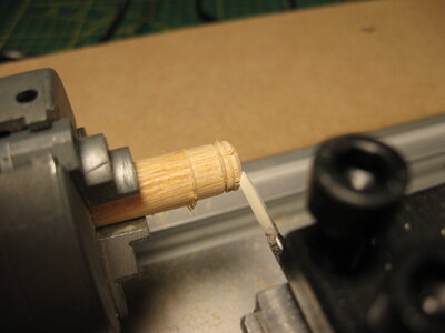

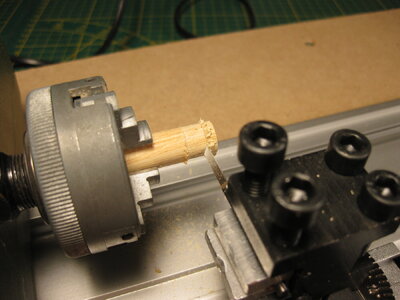

It makes the job easy on small parts, I will test also other materials like brass for example. I think that will do the job to.
