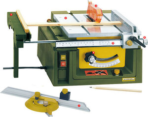

So.... with an admittedly large dose of trepidation, I finally succumbed to the saying ..... “Abandon hope, all ye who enter here”, And I placed an order for a Proxxon FET. I am going to treat it as a “stop-gap” for now. Maybe by some time next year Byrnes will be back on the job.!! SMH...
I’m still holding on to my order for his thickness sander though. There really isn’t an option for that.
So, here’s a question for all of you Proxxon zealots or fan-boys. What should I watch out for?? Any weak spots I need to monitor.??
I hope this panicky feeling goes away. I need to cut some wood and I’m scared I won’t like this thing.!!!

I have both the Proxxon and Byrnes table saws. The Byrnes is better built with sturdy metal construction, whereas the Proxxon has a plastic body.
But saying that, you will be happy with the Proxxon, as the Russian master model ship builders Dr Mike and Aldrey Kudin use it in their videos.
My Proxxon came with a error in the adjustment between the blade (motor) and the table. At the moment i heared about any guys that have the same problem too. I bought it 3 month ago and i sent the machine in the first week to proxxon to adjust correctly. She returns better but at least the angle doesent works correct.
At the moment i can work with it, but i think for this money you get nothing better.
Dr. Mike use a old FKS. I think the older machines are the better ones. The Byrnes Saw is better, but i dont know if you can compare the both saws. The size can be differnet. I have as well a little presicion saw from a private manufacturer. In my opinion there is no all in wonder tools. Every size or machine has its own qualitys.
Its depend as well how do you use and for what.
If i need to buy now one i would buy a used FKS. For this machine there are a lot of add-one and tips in the net. But this is only my opinion.
The only differences between FKS and FET should be a 0.1 mm micro adjustment of the fence on FET and electronic speed control on FKS (maybe not of much value on a table saw anyway). Hence I would think add-ons and tips should be the same for both models.
I've read that Proxxon indeed had some construction issues with the motor mount on the earliest FET but this was solved on models produced since 2010.
@Olivers Historic Shipyard: Just out of curiosity, what is the production year of your FET? (should be printed on a label somewhere on the machine)

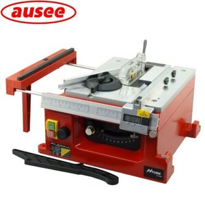

Yes, I am sure it is a Chinese copy!
Anyhow, going back to the FET (I have been using one of those),where there are two points to mention. Both are related to the parallel state of the blade to the guide. The motor can not be adjusted so any adjustment can only be done on the guide. For generic setting - and I just realized this after long years) the way to set the two parallel is the Allan screw on the guide. Make this loose and adjust the guide's position to the blade, making sure that the guide just touches the blade on both (close and far) sides of the blade. This is the only way to do it. If you have a metal cutting blade, use that for this setting because it is easier to check the guide's position to the blade. Then tighten that Allen screw.
The second issue is using the fine adjustment on the guide. It is probably caused by dust, but I could not find the position where. As the guide is secured on the linear using the yellow (twist) knob, then the guide can be fine-adjusted with the knob on the right hand side of the linear. Than the guide has to be secured with the lever. This is when I realized the sometimes while I am tightening the lever, the guide changes its angle position relative to the blade. In this case the guide has to be cleaned (after sliding it completely off the linear) by pressurized air (or, as I do it, blowing with my mouth). After this the lever could be used, as intended, without twisting the guide.

Sorry Brian,
i dont want any stress with you and i am happy that you are happy with your saw.
But i had a austrian copy of your red saw and can compare both very good.
They are not identical. Everything on this saw has more poor quality than the proxxon.
It looks like a proxxon but you don´t can compare the both machines. At the first look the
datas are similar, but the are details not. The table is very rough, the gauge is unstabil. I couldn´t saw planks with this piece of s.... unshine.
That s why i changed this saw to my FET.
Finaly the lession for me in buying tools was, if you pay the half, you get the half. ....or less....

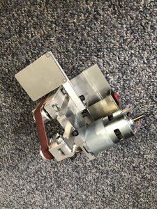

Yesterday this little baby arrived at my house. It is a much scaled down version of a big sander. Oh I know it looks like a toy but it is not. I’ve only had time to give it a small test run but it is everything I was hoping for. The best part is the same as I noted previously in regards to saws: one can sand tiny parts with complete confidence and control. No fear of having flesh ripped up. Cheap too: $65.00 Canadian delivered.
Sorry for the crummy picture. Don’t think it does the sander justice.

Wow. Amazing at the similarities. I have a sanding planner and table saw from Micromark. Basic. Nothing really to brag about. The sander will adjust all the way to where the sander is actually touching the steel floor. Larger machines have a stop gap and will not let u go all the way down. The MM table saw does have plenty of blades to choose from and they even added a dado blade system to their table saw. The whole body is plastic. The motor is tough as nails. So, all in all. Okay.
