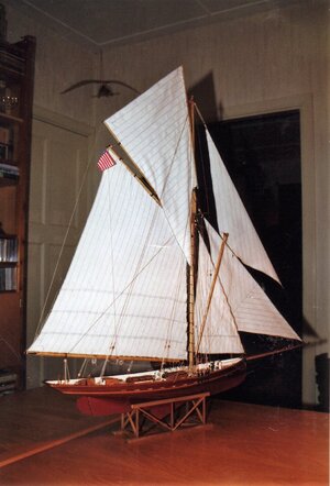

Wow! I have this kit in my stash and hope to get to it, if I live long enough. Yours sets a really high bar! I love everything about it. If I ever get to mine, this build log will significantly facilitate the building of it. Very instructive. Virtually a practicum. Beautiful rendering. Wonderful craftsmanship. I am particularly fond of the America's Cup yachts between1851 and 1937. "Britannia", pictured in this week's forum was a trial horse for the British contenders, also a Mamoli kit which are challenging. Yours is very inspiring. I'd love to pick your brain about it. Thanks for sharing!

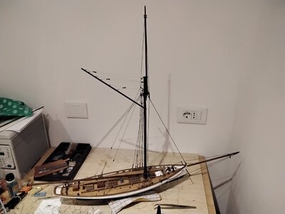

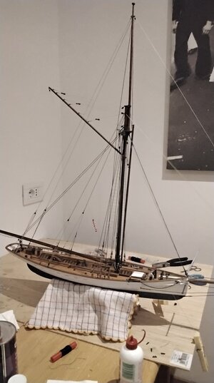

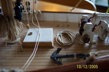

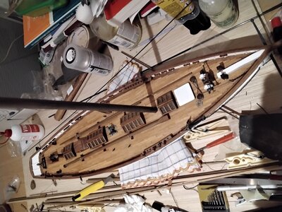

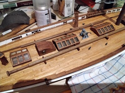

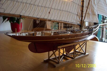

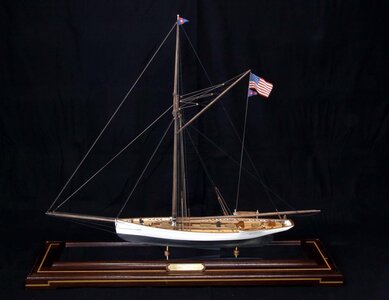

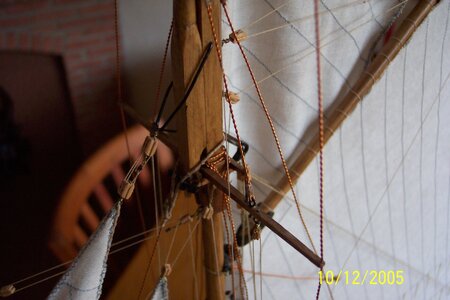

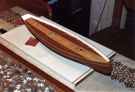

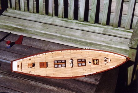

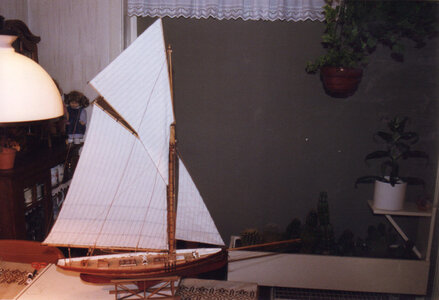

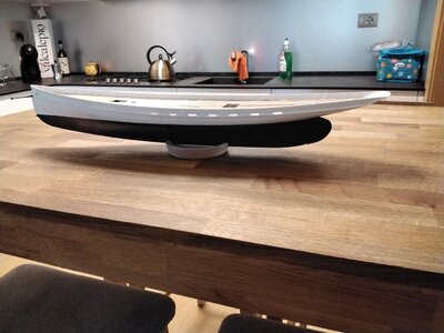

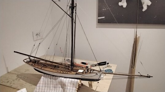

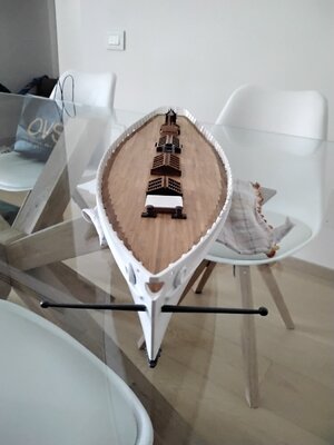

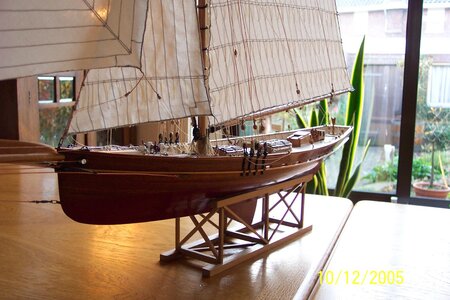

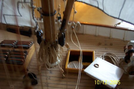

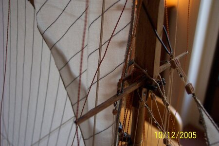

I've just done with my own version. I bashed the kit using original pictures and the guy here below. Apologies for the poor quality of my pictures. I used the original measurements certificate found in the net for the rig. Accordingly to the original dark looking, boom main-top gallant masts, boom, gaff, and bowsprit are made of walnut. Gooseneck and the whole iron works has been scratch built, as well the fork-like joints of boom and gaff. Waterways and deck planking were shaped in the same fashion of the original ones. Deck superstructures and fittings have been totally redesigned. I added the compass and the two additional hatches well detectable in the pics. Ropes and and the entire blocks inventory went from DryDock Models.

Problem is I have a 3/4 finished Amati "Shamrock V" and a Mamoli "Flying Cloud"(which I plan to do "dockyard style" with stub masts above the tops ,stays and no shrouds, with the emphasis on the hull and features on deck) both on the work bench(es) currently.

What you peered green is actually german gray. It imitates the so-called lead pot, a kind of ancient effective anti-fouling for the draft. That's the actual Livery of the boat from christening to first race eve, when the boat was dry-docked and pot leaded up to the deck level. Mamoli Puritan is based on poor sources, like the majority of pre-internet kits. Even the profile view is wrong if compared to Ed Burgess' original plans. So, if you ever mess with it, prepare to bash it radically. Cheers!

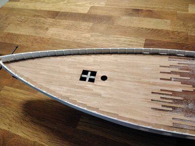

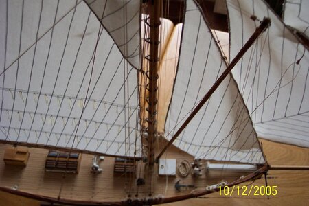

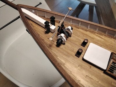

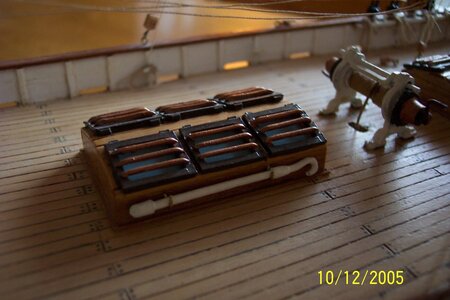

I'm flattered by you kind words. Just in case you want to procede with Mamoli Puritan, consider that the gossest mistakes concern the centreboard (21 feet actually) and the keel lenght (longer in the actual boat) and consequently the stern rake (shorter in the reality). Rig scantling is availlable on america-scoop. Mamoli's deck lay-out is awful as well: I didn't use a single single component came with the kit. The centerboard and anchor winches are totally wrong. For the first, I used the pic of Mayflower deck (1886 defender) a truly puritan lenghtened version. For the latter, I have considered the pic of that fine model plus a scheme I found in the net.
Cheers,
Alberto
Wow. These pics are very helpful. Are the winches from scratch? How much length added to the Keel and centerboard? I like the deck planks joggled into the waterway. The book I told you about is not very helpful with deck layout and rigging plans. Britannia's rig and layout was changed so often, that trying to nail her down to 1924 required a lot of speculation cobbled together from an assortment of photos spread over 40 years, as well as a set of plans for a big R.C. version I got from the U.K.

For the daggerboard see https://5500.forumactif.org/t1198p25-puritan-sloop-de-1885. For the to keel lenghtening consider an inch or so. For the anchor winch I used drums and the two vertical elements (in white) came with the kit. The daggerboard's one is made from scratch (gears are stolen from one of my child's coil-powered car...).

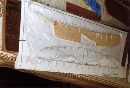

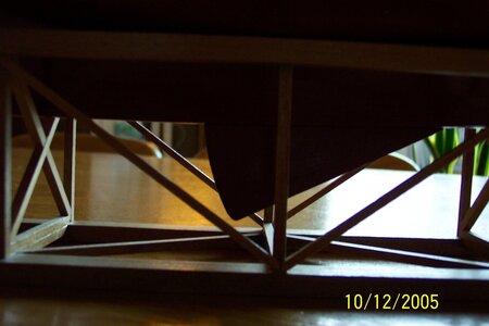

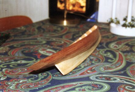

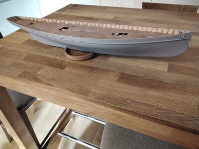

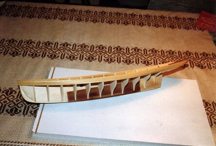

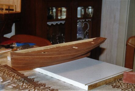

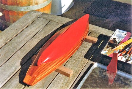

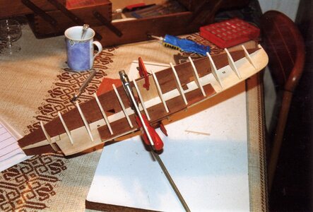

Sadly I started the kit in 1996 and abbandoned it for some 25 years (devoted to stuff like the one below) well before any web source availability, then my version is barely standard in that respect. The pics are referred to another work. Anyway, a solid piece of soft wood directly glued to the stem post before planking would surely work properly. Once you do that and once you bash the centreboard slot, the sheer plan would be ok.

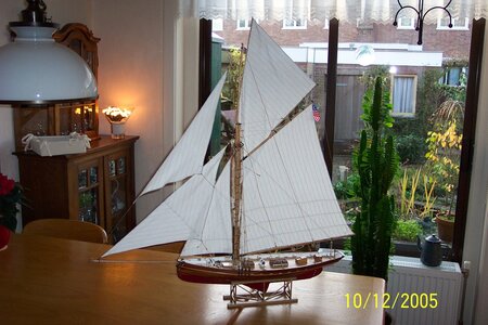

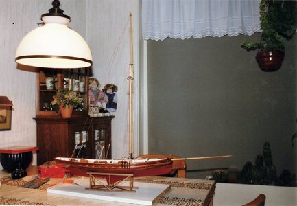

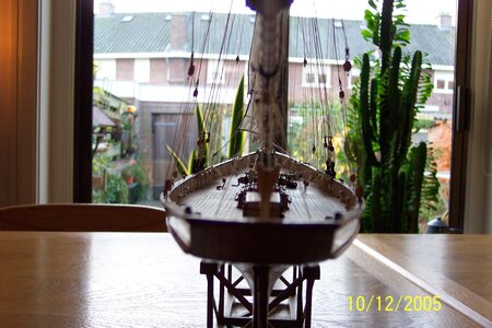

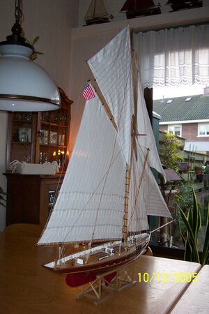

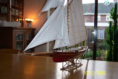

So.. was the choice to leave the 2005 Puritan version in natural wood with the red bottom (assumes the color challenged guy) purely aesthetic ?
I looked up the "Mayflower'. Looks like an updated and very much faster version of Puritan.

Alberto, fantastic job on your boat. Not only is the sailboat beautiful but your home in Milan is as well! Great outdoor photos! Magic Mike

Thank you, Mike. I just realized how messy was my home in those pics... ahahah. Here the same home in bit better shape. Totally agree on E-Type as one of the most baeutiful car ever. Congrats on your ownership!!!
