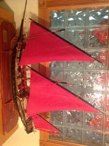

I built that kit about 5 years ago. I did remove some laser char before assembling the frames, but I faired the hull after gluing the frames in place.
