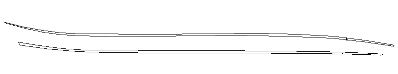

For anyone that has properly spiled planks or even preshaped planks with hot edge bending, these laser cut planks might be a huge bonus, assuming they have been shaped by spiling. Look at the shape of planks on contemporary planking expansion drawings and those in the kit appear to be correct. An example of the fifth strake above the keel and the 14th stake above the keel on the planking expansion for the Artois (38) class is below. These are the shapes of the strakes when laying flat before being placed on the hull.

With the laser cutting technology being so advanced, there's no excuse not to have pre spiled planks with every kit these days.
The manufacturer would have to make sure the planks are an accurate fit.
Of course being able to spile with confidence would be a tremendous achievement to be admired.
