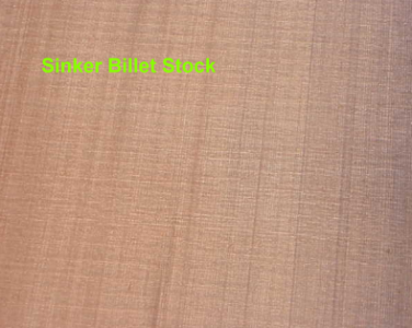

Finished instrument grade redwood stock:

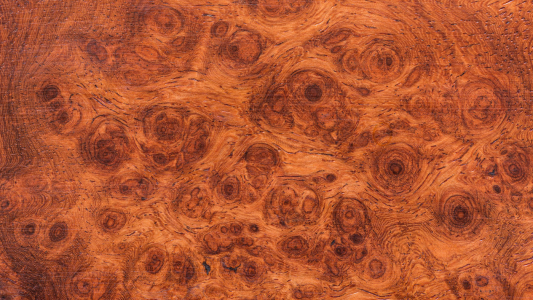

Finished redwood burl:

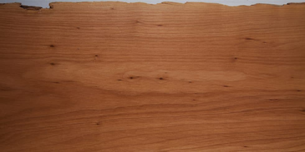

Flat sawn Swiss pear wood:
