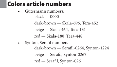

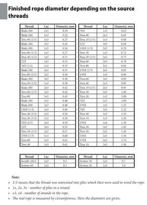

i have a planetary gear type rope making machine. I have yet to use it as I have not needed to make rope until now. The kit I purchased sadly doesn`t have enough rope to complete all the rigging, and I was thinking of using the machine. I was trying to put some science towards making ropes. I think I`ll have to set up some sort of experimental design of experiments and see what I get, which is ok. I don`t mind this sort of stuff because I am in no hurry.
There is no way to accurately predict final rope diameter for unknown threads / yarns but making tests. For known thread brands and models there could be charts. I use only the attached ones. I experiment with different rope constructions as I go. For example I made 1 x 4 constructions with some yarns to get rope diameters that are not in the chart.
ok. thanks for the info. I have different size threads so I can play around a little before actually making what I need.
