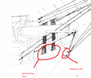

Just wondering if anyone has photo of how the Constitution Gammoning is done? I am in the process of closing up the rails in the stem of the ship, and I am concerned that the gammoning will not be accessible with closing of the toprail done.

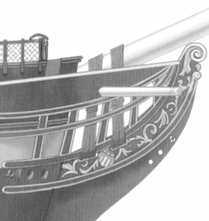

in the following image taken from the Bob Hunt instructions, you can see the two holes for the Gammoning and I believe that chains are used in this application. However, if I close off the top of the stem, then pulling the chains through those holes will be next to impossible. I don`t know how the chains are attached to the bowsprit itself. The plans show some metal straps on the bowsprit, but how do the chains attach to the metal straps?

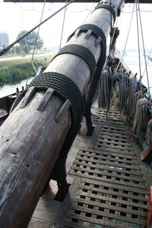

thanks. I had seen something similar to this. I guess I`ll have to make a decision if I want to use chains or traditional rope.
that is interesting. The plans show it as chains. Maybe I should just make the holes into slots and gammon with rope.
Everything aboard a ship at sea is dynamic. In other words parts try to move relative to each other. This is especially true of wooden sailing ships where 1000’s of parts were secured with rope lashings, wooden treenails, etc.
The bowsprit was a heavy wooden spar located in a part of the ship subject to high accelerative forces from pitching. It would try to whip up and down relative to the hull structure. Chain gammoning being much harder than wood would act like a saw damaging the spar. Rope, an elastic material would allow the bowsprit to flex.
Can you post a picture or say who drew the plans? To be 100% sure, send an email to Carl Herzog or Kate Monea, curators at the Constitution Museum and they will give you the correct information. If you don't already have the email address, PM me and I can send it to you. I would post it here but it is not a good idea to post email addresses on public sites,,,,, learned the hard way.
yes, the holes for gammoning should be slots. the bobstays would be just circular holes. Can you please provide a picture of the instructions?

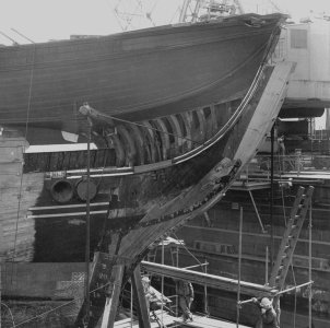

Here is a photo from a 1960 era restoration showing how the gammoning chains are secured to the hull. BTW, the image of rope gammoning in post #2 is NOT from the USS Constitution. It is just an example of rope gammoning.
Jon
Great photo, thanks for posting it. I wonder when they first put chains on instead of rope, but at least we know there were chains at some point.

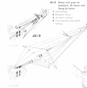

Here is the image from AotS book on the Constitution which plainly shows rope gammoning.
As does this image that is on the cover and the pages of index
Jon

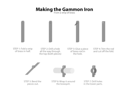

I haven't gotten to point where I am installing the gammoning yet, but I plan to use chain because my model is based on the actual ship's contemporary look. However, I must take into consideration the choice between a model which just must look good versus a miniature reconstruction which must reflect the actual construction. I choose to make a model. That being said, my plan at this moment is to make the horizontal clamps that sits on the bowsprit and attach the chain to an eyebolt on the bottom side of the flange. The chain will drop down and be needled through one of the two predrilled holes under the bowsprit and back up the other side to the clamp where it will fastened to the other eyebolt on the clamp. This will be done for two chains. Mechanically it will hold the bowsprit fast. Making anchor eyebolts like the 1960s image would be too complicated and for the effort, won't even be seen. Hopefully my simplified method will do the trick and no one will be able to discern what method was used.

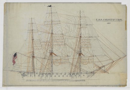

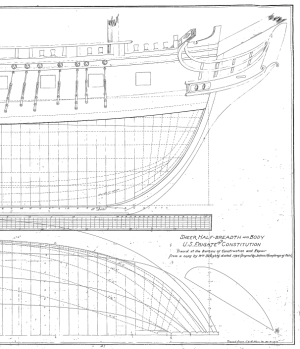

From what I've seen, it depends on the time period. I have attached a drawing from the National Archives files of the Sail plan for 1817 which shows rope. If I'm not mistaken, the current configuration of the ship is to reflect her during the war of 1812.
Corsair II. See my post #6 above. Neither the kit nor the vessel on display at Boston reflects Constitution as she appeared in 1812. Among other things, her ugly boxed in head is from a much later period.
Roger
