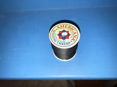

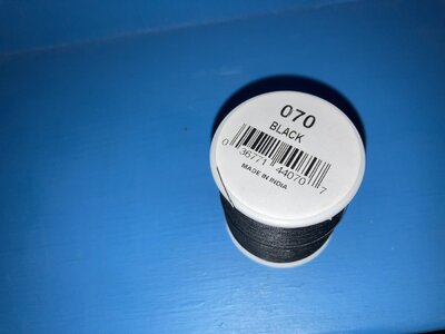

I use black sewing thread for all ratlines in the mid scale range of 1/48 to 1/54 or so. Get it from any sewing accessories store like Joann Fabrics or even Amazon. I find regular cotton/polyester blend sewing thread works nicely and maintains scale…
This is a glazed cotton thread. The coating keeps the thread stiff and gives a better appearance to the ratlines. Yes ideally the ratlines would sag, but, there is simply not enough weight to the thread for gravity to assist in the sag.

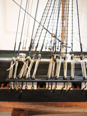

I noticed that the ratlines don't go to the foremost shroud except for every sixth one. Is this normal? I'm not anywhere near rat lining so I know nothing but this kind of jumped out at me :)
Yes, only on the Mizzen lower shrouds do the ratlines go all the way across. Earlier ships than, say, 1775 may not be so rigged. Just FYI, and if it is OK to do so here, if you go to my thread on the USS Merrimack 1855, I have started a series of U Tube videos on scratch building sailing war ships. Right now I am serving the shrouds and stays. Perhaps it would assist you in your own build? I will be doing ratlines in a few weeks if things go as they have.
Different ships do things differently. That picture is of a different model than the SR. The SR has ratlines tied to each shroud.

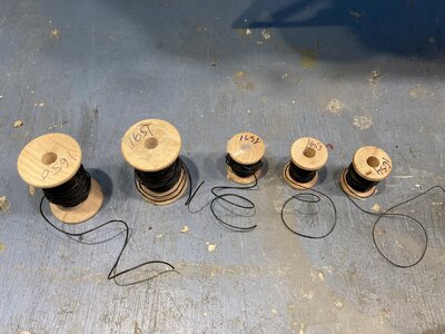

Bud, I ran out of shroud thread early on and had to substitute or just make do. You'll need a lot more line if you're doing sails as well. I used a lot of sewing thread for some of the areas because it looked to be better scale. The discussion about wrapping around a dowel 10 times, measuring with a micrometer, and dividing by 10 works well for determining thickness. Then you can order some. Except for the shrouds, I only used half the thread supplied. I often substituted. I think ZHL skimped a little on the thread and on a few of the stick sizes. If you look at my build log by clicking on the model name in my signature block below, you'll notice I ran out and either ordered some from another source or contacted ZHL for more. It was during the height of covid, so it took some time to reach me.
