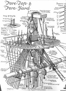

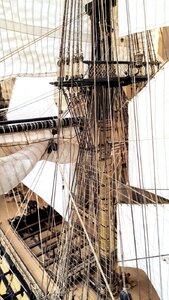

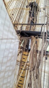

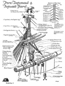

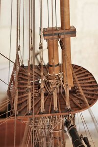

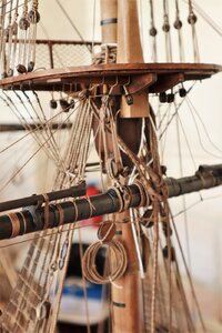

It depends on the construction of the top and how the seamen were climbing over the ratlines to the top
1) If there are ratlines installed at the futtock shrouds -> than usually were no ratlines at the shrouds above the futtock stave
Take a look at these sketches and also the photos of the model which are explaining the situation:
2) if the sailor reached the top climbing through the gap between top and mast, than there were ratlines necessary up to the top of the shrouds, but than no ratlines installed at the futtock shrouds
But I guess, that the HMS Victory is one of the solution 1)
Dear Uwek
Thanks alot much appreciated. Your reply fully explains my question and is also in line with my understanding. Yes in fact victory has futtock shrouds so case 1 applies.
Best regards
David

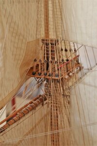

Hello, voici comment j'ai fait ces enflechures (ratlines) sur mon modèle du Victory
Hello, this is how I did these ratlines on my Victory model
Francis
Many Thanks for sharing these details of your lovely model - I would like to see much more of the model
BTW: we met two years ago during the International convention in Rochefort.... I was part of the german delegation.
For all other members: I made some photos of another model Francis brought to this event:

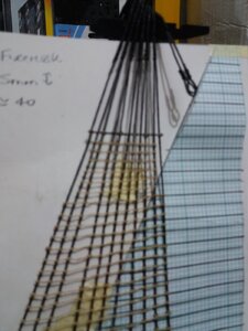

Ratline spacing depends (obviously) on the scale but for the scale 1/50 range if you use a 3 x 5 lined note card the lines provide a fair spacing guide for the rat lines. What I do is clip the 3 x 5 card behind the shrouds and knot the rat lines onto the shroud using the lines on the card as a guide. The card provides not only a spacing template but also a line template across the shrouds that helps keep the rat line parallel to the deck.
