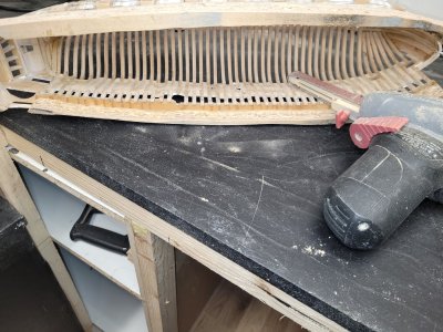

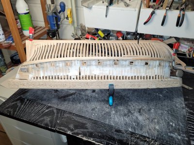

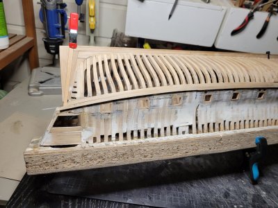

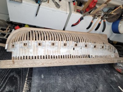

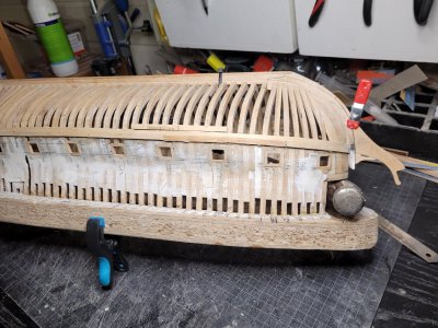

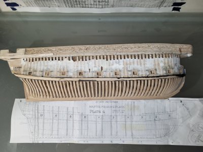

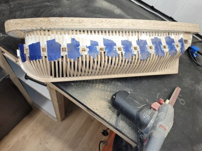

A final insertion of a new plank in Hwales.
Used black ink on the edges, now there is only one final touch up after planks above and below Hwales.
