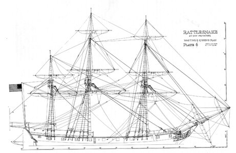

Am I wrong in thinking the model shipways plans for the rattlesnake build are less than adequate?

They.are.simply.horrible. I wouldn't recommend the Rattlesnake for a first time builder for the sole reason the practicum leaves so much out. I'm actually using the rigging plan from two other models I've done as the one sheet showing rigging is hopelessly confused and again, leaves much to the imagination of the builder.

I am building this model,as a first build at the moment. I find the rigging plans more than confusing. I am following TKAM's build log as he solves many of the confusing issues.

Having issues with mast platform area. Plans not clear on mast going thru cross trees and tresle trees and up to mast cap.
I built the mast platform from scatch even though they don't show a platform on the plans. I just thought is appropriate as most/all ships would have some sort of platform for each and every mast. I also scratched the mast coats as the laser cut "circles" for the base of the masts were all too small and fragile.
