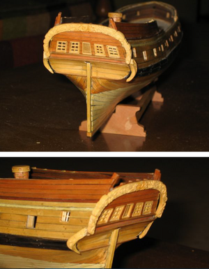

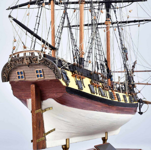

Examples of the Model Shipways kit build:

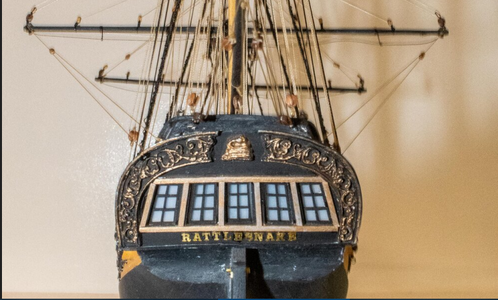

Fomr the build log of Robert Hunt, on bashing the Mamoli Rattlesnake:
Robert Hunt hand carved his decorations:

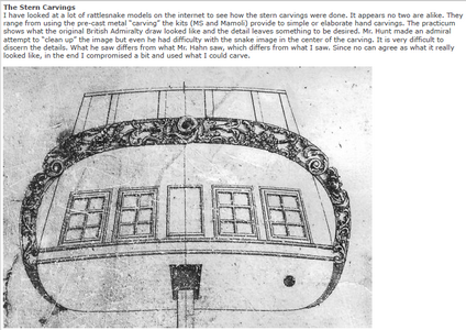

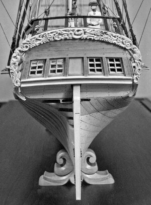

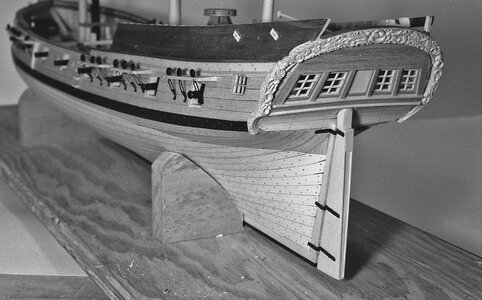

Probably the best interpretation, from Harold Hahn's scratch build:

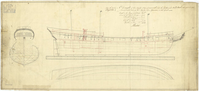

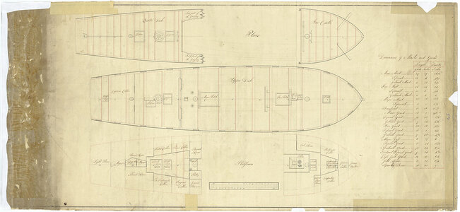

Maybe you do not know, but there is a contemporary drawing also existing
Cormorant (captured 1781)​
Scale: 1:48. Plan showing the body plan, stern board outline with decoration detail, sheer lines with inboard detail and figurehead, and longitudinal half-breadth for Cormorant (captured 1781), a captured American privateer, as fitted at Plymouth dockyard as a 12-gun Ship Sloop.
Signed by John Henslow [Master Shipwright, Plymouth Dockyard, 1775-1784]
Reverse: Quarterdeck, forecastle, upper deck and fore & aft plaforms with table of Mast and Yard dimenions for Cormorant (captured 1781).

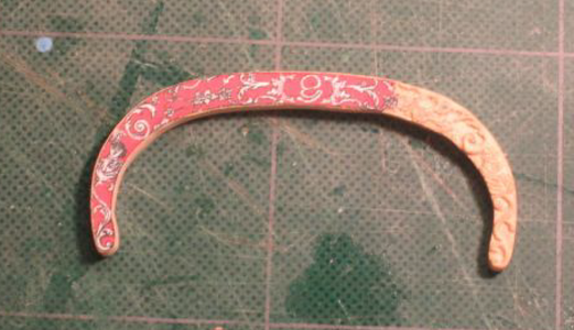

Mamoli upgraded their kit with laser etched wood for the stern decorations, which is a nice touch, and is not as thick and gaudy as the metal cast carvings used on the Model Shipways kit. It could still be improved upon by use of handcarved decoration. Both Mamoli and Model Shipways are decent kits, but I believe the wood is superior in the Mamoli kit. Either one can be used as a basis for a bashed model of Rattlesnake.

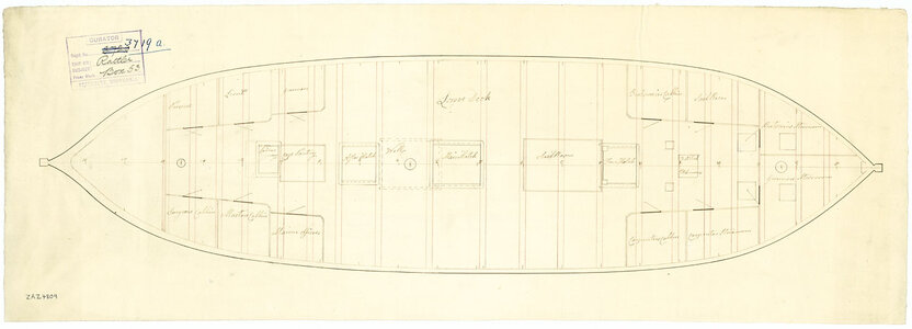

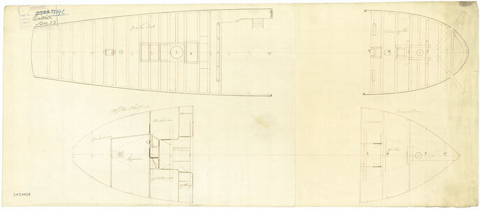

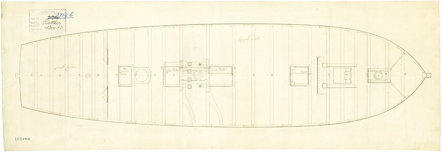

More... are these attributes to the Rattlesnake or some other vessel? I can't read the name in the script.

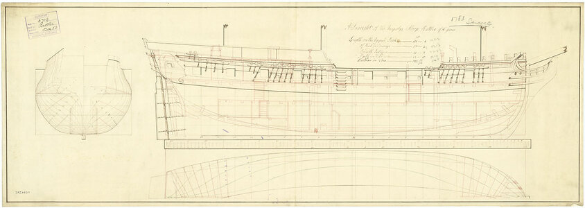

These drawings are the HMS Rattler from 1783, 16-gun Sloops with quarterdeck and forecastle
Rattler (1783)​
Scale: 1:48. Plan showing the body plan, sheer lines with inboard detail, and longitudinal half-breadth for Rattler (1783), a 16-gun Sloop, possibly as built. The plan shows the influence of French design on Edward Hunt, the designer, such as the exaggerated tumblehome, the stern gallery layout and the curve of the upper part of the stem post.
Reverse inscribed: 'Rattler Sloop (16 Guns) similar to French - with Plans as Built'.

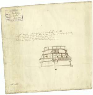

This is the stern drawing
Rattler (1783)​
Ahhh. Wrong ship!!! :rolleyes:
I tried my best with the transom on the rattlesnake. It looks OK it’s not the best, but it was the best that I could do given the materials that I had at hand. I can’t say which model is better but I would be inclined to think model ship was Has a better track record for quality That being said I’m working on the castle railing and I was wondering if anybody else is in that stage of the model I could certainly use help in the construction for assembly of the vertical rails
