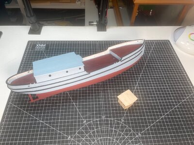

Hi All,
After having couple speed build videos completed on my YouTube channel, I got my first sponsored model kit, the BB605 RCMP St.Roch 1:72 scale from Billing Boats.
This was an advanced beginner kit and should be very straightforward. The plan was good but the instructions could be better. The kit was well packaged and so far I did NOT see anything missing.
I will keep the build log coming and as usual to film the entire build process and upload to YouTube after done. Hopefully, my build log and final video can provide some help to anyone who likes to build the legendary boat model.
Thank you and good luck building!

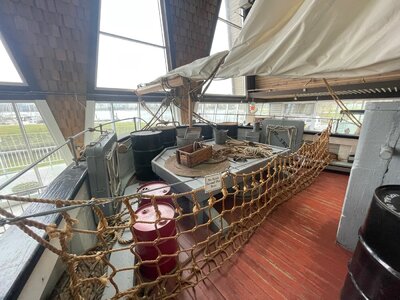

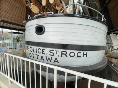

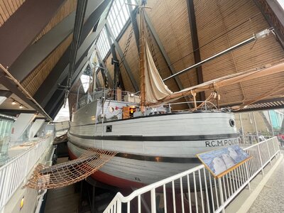

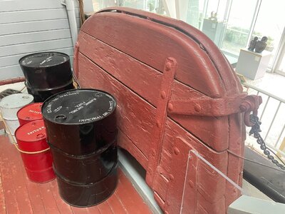

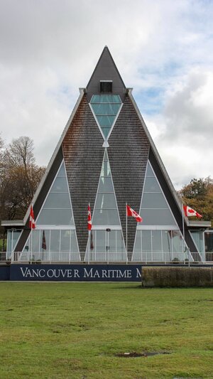

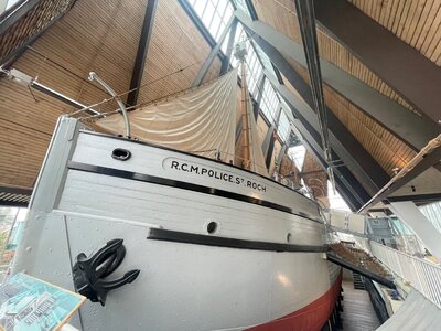

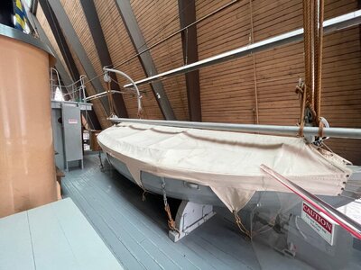

I am going to pay a visit to the Vancouver Maritime Museum to film the real boat too. I have been to VMM for few times but realized that I NEVER took any closeup photos of the boat. The photos below were taken when I was there number years ago. I will take some good ones and film a video this time.

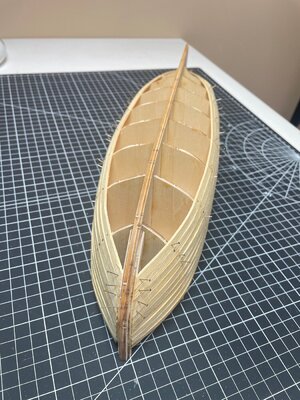

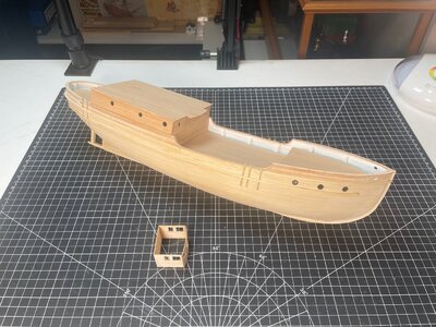

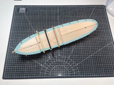

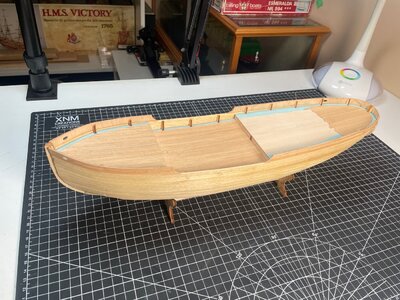

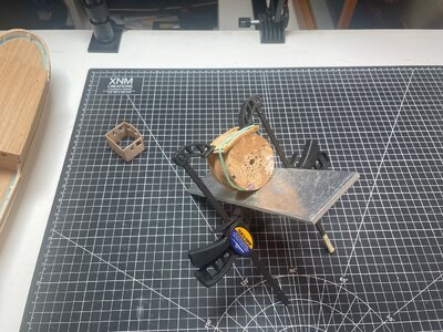

Hi all,

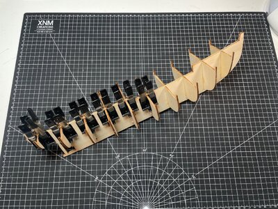

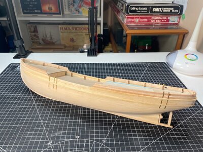

I am making some progress on my St.Roch build. Certainly it is doubled the work with filming and building at the same time, but I think the final video will be good.
I think I just developed a new hobby while I was enjoying another.

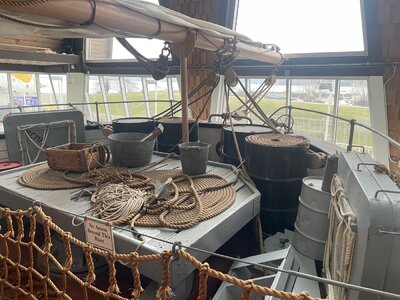

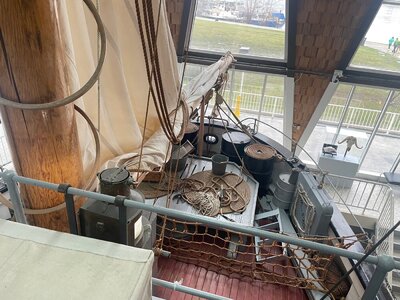

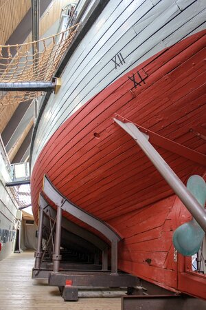

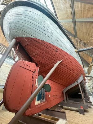

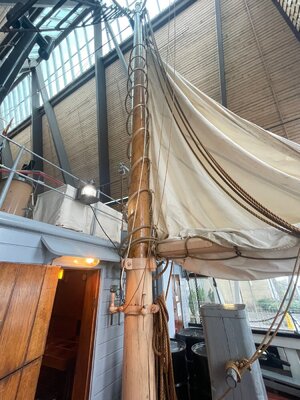

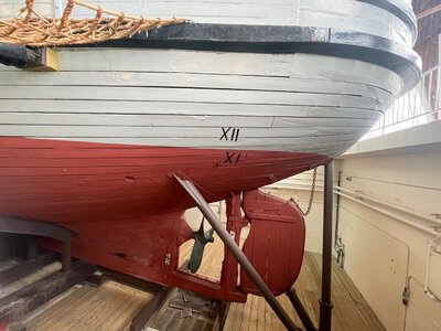

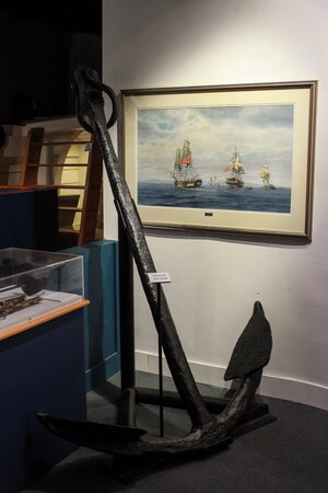

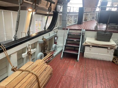

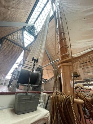

I also paid a visit to the Vancouver Maritime Museum and took some pictures of the real boat last Friday.
RCMP St. Roch was very famous boat back in the 60s and 70s, unfortunately, only few people were there the day I visited. Maybe some new technology could be used or involved to attract more people to the museum.
Some great progress Edward with some useful photos. I’m looking forward to seeing your videos.

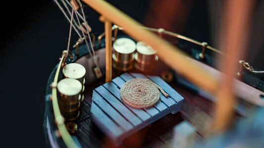

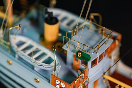

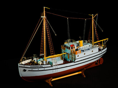

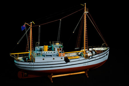

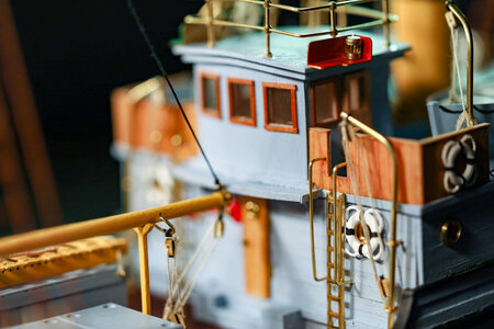

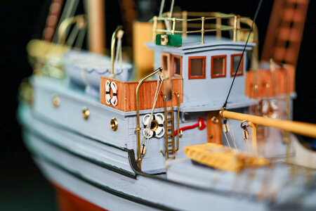

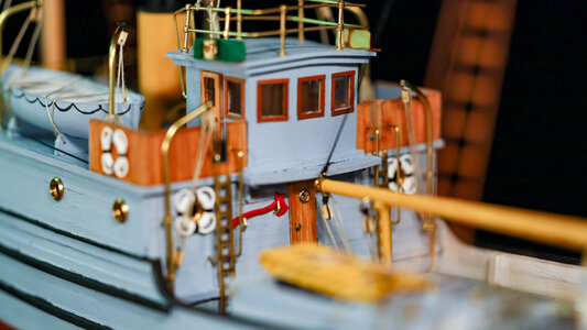

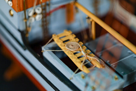

Finished photos look good, but from a old photographers standpoint you might look for light grey or medium grey or blue background.
Several photos you have rigging and blocks hanging in mid air, as the black lines going to them disappear in the background.
Great looking model for a fast build. I look forward to watching on YouTube.
Thank you and Good catch, Kurt. You are right, the lightings will be my next big investment. I used halogen work lights so the white balance was way off as well as it was too harsh.
I will fix them once I have approval from my boss at home, lol. Please stay tuned.

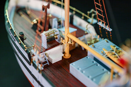

Hi Edward, I really enjoyed looking at your video and the accompanying photos. The St. Roch seems to be quite a popular build, especially for Canadian members of SOS. Showing your build and also the museum photos will no doubt help others interested in this famous little ship. It is one of those models that can be built out of the box or greatly enhanced with lots of extras.
Thank you, Roger. Glad you liked the video.

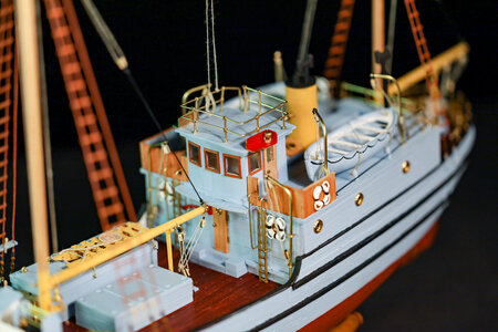

Congratulations for finishing this very attractive model
and an interesting vessel in addition
Bravo - well done Thumbsup
I will be adding this to the Gallery, and a little photo editing can bring out some of the rigging that can not be seen. and actually, there are several modelers that prefer a black background. For instance, Olha of the ship modelers' photography always uses a black background.
Thank you, Donnie!
