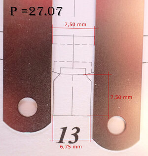

in my opinion what is written in the monograph must be taken into account and then checked on the drawings, the thumb is 27.070, I don't have the monograph I reserve the right to make observationsHello Tobias,
My apology for asking again, but I still guess that the keelson is 7.50 mm wide and not 6.95 mm.
Statement from the monograph:
On plan 7 it looks like that the part you are measuring in the picture above is slightly smaller than the keelson:
Measurements from plan 11:
Please see also the cross section of frame 30 on plan 11 for the different dimension of the keelson and the part with 6.95 mm width
