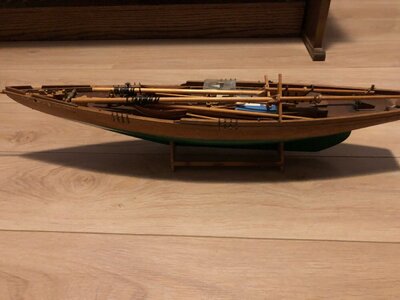

First picture is the model after I removed all the sails and standing and running rigging.
Note that my father decided for a look "au naturel", except for the hull below the waterline, which he painted green.

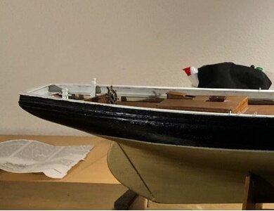

Painting the hull.
As stated before, I went with the colors as specified by BB. This means white inner bulwarks, white railings, black hull above the waterline, gold(!) below the waterline and the waterline a duck egg blue, which turned out more like a duck egg green…
According to a letter sent in 1970 from Smith & Rhuland in response to an inquiry from a modeler, the lower hull should be painted a “red copper”. The complete letter (and the colors used on the original Bluenose) can be found in the Bluenose Practicum Standard, pages 135 and 136.
So I went with the BB specified colors and the picture below shows the outcome of my paintjob below the waterline, after applying the first layer of paint.

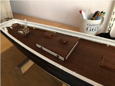

Initially I wanted to forego any painting of anything installed on the forward- and aft decks.
Once I completed painting the hull I reevaluated my earlier decision, the model really looked kind of boring, but also the balance was gone. The hull painted, the masts painted and none of the deck structure having any finish just didn't make sense anymore.

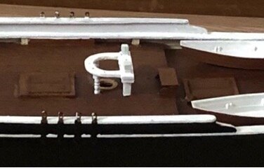

When looking at the picture below, showing the deck details of the wheel house and the main cabin, you’ll probably get my drift. So I started using tape…
The result is a more appealing looking of the various deck parts, although to this day I have second thoughts about the deck color. BB specifies “trainer yellow”, whereas the original should have its decks “oiled resembling varnish”. So essentially, the deck color on my model is at best too dark. What held me back, was, that in order to properly treat both decks, I had to remove all deck equipment, which was bonded to the decks. Since I had no idea what damage I could incur to the decks, I decided to leave the decks as they were…

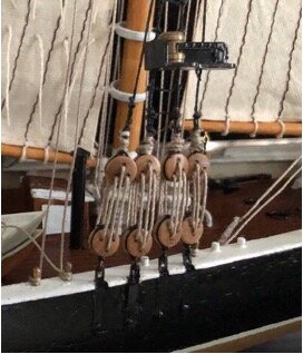

This is how a make my coils and hanks. It's similar to the method another modeler shared on his website.
The hanks needs to be quite narrow, otherwise I can't have them next to one another on the belaying pins. The coils are wrapped around the pins and then, by look and feel, made to look not too tidy.
Hanks: Trick is to not wrap too tightly (and a lot of patience). I use some cuts to hold the ends of the rope for ease of handling (an idea of a fellow modeler, which proved to be quite useful).
Coils: Nothing really special here. Initially I worked with four pins. Don't go there, just spend the time to add just a couple more pins...
I fix the coils with a drop of glue at two places, then,after, drying, remove it from the pins. Then I use my fingers to get a more cluttered look.
And this is how it worked out around the foremost, with hanks on the belaying pins and coiled ropes on deck. There may be room for improvement, but is sure beats just cutting the ropes and leave it at that (it's how it was done on this model, some 40 years back).

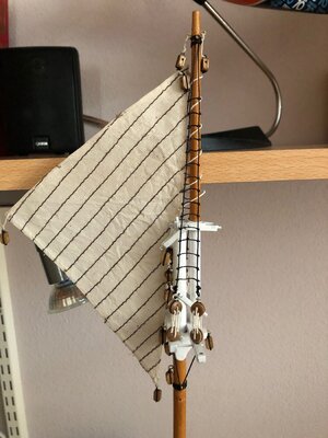

After applying the paint I turned my attention to the sails. The model came with, what I thought, a complete set. The sails were from the original kit and quite thick, especially when compared to other sail material, like from Amati or Mantua.
First thing to do was wash them, to get rid of forty years worth of dirt and grime. It was a gamble, because I didn’t have a clou whether or not the old sails could withstand this treatment, but hey, they came out surprisingly clean and in a pretty good condition. Just some light ironing was required to get out the wrinkles. Wear and tear could be seen in basically all corners where the sails were attached to the running rigging and to the gaffs and booms. Normally one would opt either make a new set of sails, or for a no-sail display. As I was committed to not only rebuild the model, but also to pay tribute to my father, I opted to use the sails as is, with the exception of the reef lines in the main- and fore sails; I decided to add those. I think they’re (just a tad) too long, checking with old pictureS of the BN they definitely are, but visually it doesn’t look bad and I don’t know what will happen if I shorten them to a more authentic length, my guess is that they will be even more uncontrollable than they are now. So for now, I leave it at that.
The picture below shows ao the reef lines of main- and fore sail.
During the paint phase of the project I also applied white accents to the masts, gaffs, booms and masthoops, so once I finished applying the reef lines to the sails, I attached the main- and fore sails to their respective booms and gaffs. At that stage I also attached the masthoops to the sails.
While working on the sails, I tried to establish when to attach the sails to the masts first or wait until I was done with the standing rigging. After checking out a number of build logs, where I found builders advocating to mount the sails, prior to joining the masts to the hull and builders who would mount their sails after the masts were properly installed, I decided to for the pre-mast install option.
At that time I anticipated quite some accessibility issues with attaching the sails to the masthoops, with masts and shrouds in place. Turns out I still had accessibility- ánd visibility issues with setting up the running rigging.
Both gaff sails were also attached to their respective masts and the top shrouds were installed.
After that my attention was shifted to equipping both masts and gaffs with the appropriate blocks and eyes, all per BB instructions.
The picture below shows the fore mast, with the gaff sail installed and the top shrouds in place. Also a number of blocks are installed. Later I had to redo some of them, since I was not satisfied with the results once the running rigging was applied.
