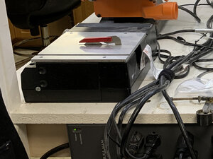

Hi there. I'm wondering what kind of table saws you use and what recommendations you would have. I currently use the MicroMark saw shown below. It's nice but limited. Please don't suggest the Proxxon FET as I've already gone that route and returned it because it was out of alignment and can't be adjusted. Thanks for your helpIMG_0438.jpg
I think this all depends on what you want to accomplish. Personally I would not spend the money on a any hobby size table saw. My reasons are first they are limiting as where a 10 inch band saw has far more uses. Second a table saw has a limit to how thick of material you can cut so at some point either you have to resaw larger material down or purchase resawn material.
Unfortunately, there is not to many to choose from... You already dismiss Proxxon, so we left with Microlux by Micro Mark (similar price as Proxxon) and Jim's Byrnes saw. I have not use Microlux, but I am happily use Jim's tool and consider one of the best tools in my ship lab (sorry, i don't call it shop) :p
It doesn't tilt the blade and some consider it as limitation, but without tilt, it adds to pression. I am able to resaw 0.6mm thick strips... The only drawback - is cost... But you pay premium for pression.
Paul I was actually going to recommend you do NOT buy the FET but you have covered that alreadyROTFI have never heard anyone complain about the Byrnes saw who actually own one
