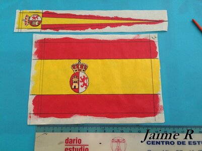

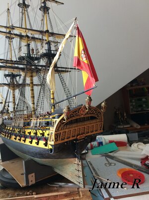

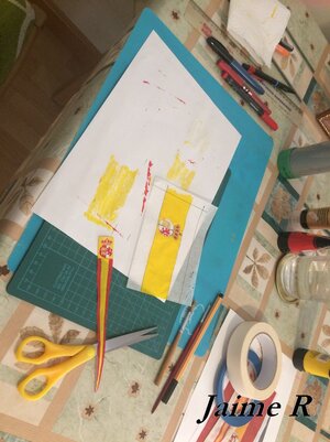

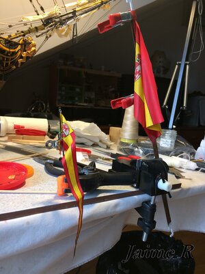

Hi Chris, I’ve used silkspan painted with acrilics with quite satisfactory results. Maybe you could test the silkspan in an ink-jet printer. It is very resistant.
Greetings
Jaime
5BA53027-D5DB-4A7A-AF79-7F9B82A1243B.jpeg2566EE3A-F62F-450C-A60E-4E2C75D81014.jpeg0CD51C1D-8A95-4C99-9BC4-662FB2FC95A1.jpeg199B0679-1681-4EAE-90FE-62FFDB65B93A.jpeg
