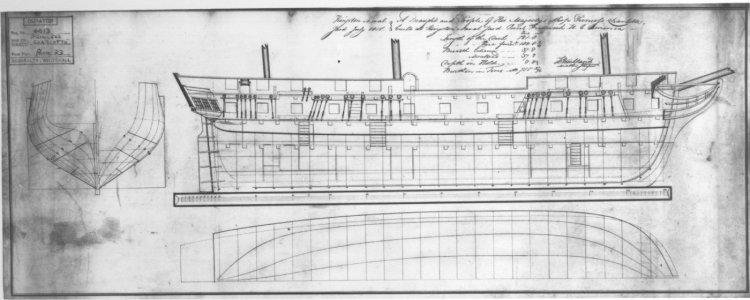

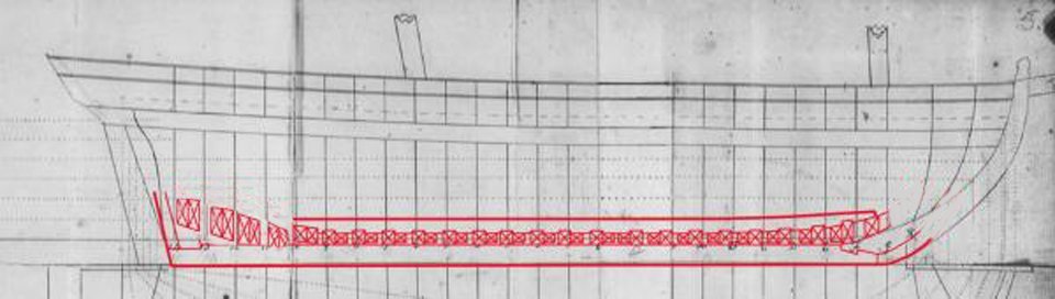

For example the Princess Charlotte built on Lake Ontario 1813
here is the admiralty drawings you can see there is nothing to show what the stern looked like. So do you stop there with a model that should not be built because we have no clue as to how the stern looked. You as a builder can reconstruct a stern.

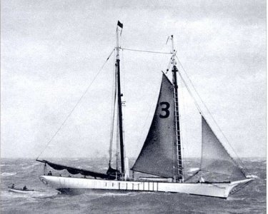

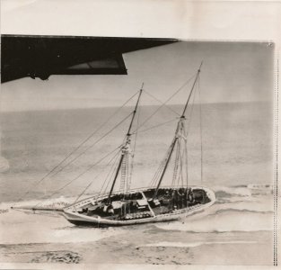

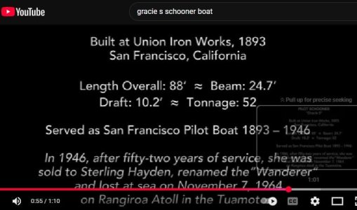

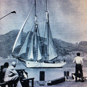

Lucky the GRACIE S was built in 1893 but there are pictures of the vessel so what did the GRACIE S look like?
1_b5ea4876b56726c2b36d99096d24f657 (4).jpg500737981_2791321374387786_2712330239794978439_n.jpg500764432_2791321194387804_3299882237118163857_n.jpg

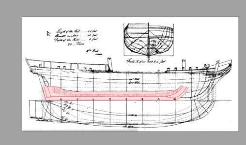

The education of young naval and army officers included lessons in drawing. Not mechanical drawing but sketching the World around them. This was partially intended to improve their powers of observation. If one takes the time to determine who made the drawing and under what circumstances he drew it they can be valuable sources of information. An example:
Row Galley Washington: An admiralty draught was made of this vessel following her capture, and dozens of models of this interesting American Built vessel have been built from drawings made by Howard Chapelle based on the draught. There are also two of these “on the spot” drawings made by naval officers who fought in the battle at Valcour Island. These show a vessel with a different appearance.
Following her capture Washington was taken in hand by British Naval Constructors and rebuilt as a brig. As the RN then controlled the waters of Lake Champlain she became an armed transport no longer a warship. The draught, therefore, does not show her original appearance. An accurate model would require using these sketches made on the spot to back out the changes made after her capture by the RN.

The GRACIE S. we've got plans that say she's 95' 6" on deck and a fairly extensive, but "unofficial" description that says she's 95' 6" on deck, but we've got Mystic Seaport listing her as a "96.5' schooner." Then we have the Dictionary of American Naval Fighting Ships which describes Gracie S. as "length 83' 0" then the on the German Wikipedia page we have 92 feet in historical archives we have 88 feet.
Saltwater People Historical Society
"Seattle acquired another picturesque pleasure craft in the GRACIE S, a 96-ft power schooner, built in 1893 for the San Francisco Pilots Association.

Conflicting information is common when researching so you have to compare and check sources to one another. Let's get back to the Princess Charlotte the heavy armed frigate built during the war of 1812 on Lake Ontario.
There is evidence that the Princess
Charlotte
lines drafted by Strickland may be inaccurate. While the length of the keel is stated as 100 feet (30.48 meters) on the plan, the actual measurement is 118 feet (35.97 meters). Significantly, a later historical document lists the keel at 121 feet 6 inches
