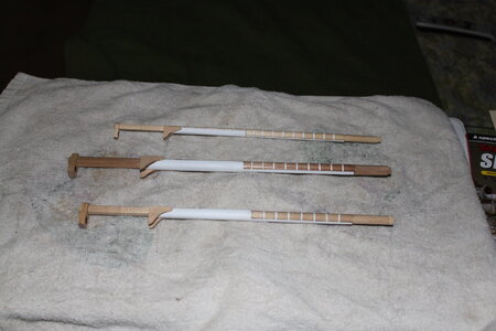

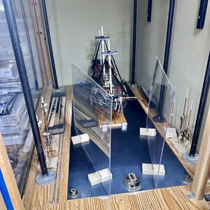

I have been building the Model slipways Constitution over the last ten years and have decided to bring it out of dry dock and finish her up. I have been using the Bob Hunt Practicum. This is my dry dock on by building work bench. It makes it easy to slide the model in and out to work her and put it away out of danger when not working on her. I am a retired farrier/blacksmith so the sliding base is made out of 16 gauge sheet mental and the model base is held I place with magnets.

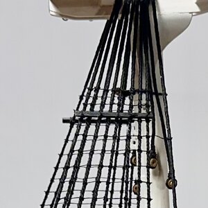

I am at the point of attaching the beatnik rigging and staves to the foremast. I have made all my rigging line myself using the Byrnes Ropewalk. I used about 8 different thread manufactures using cotton thread. That way I get 8 single strands, 8 three strands, and 8 triple strand sizes for 24 different thread sizes. This is an improvement over the few thread sizes given with the kit. I feel it gives a more realistic look to the rigging.

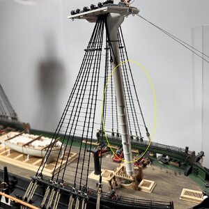

Good morning Thrasher, excuse me what is this detail, Thank you ,Frank
Hello Frank. The area you highlighted is on the front of the mast. It is a covering on the front of the masts called a chafing fish and is on sheet #6 of the Plan sheet for the Constitution. It protects the mast as the yard is lowered o r raised.

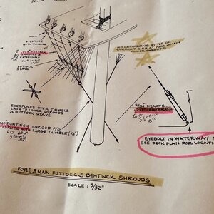

I am at the stage of installing the bentinck shrouds on the fore and main masts. From the diagram on sheet 7 of the plans it looks pretty simple. A few hooks, some thimbles, a ring and some rigging rope. The only problem I see is that this all has to be done of the model!! I need to figure out a plan to do this without destroying shrouds. There does not seem to be many builds that have entered the rigging zone.

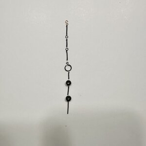

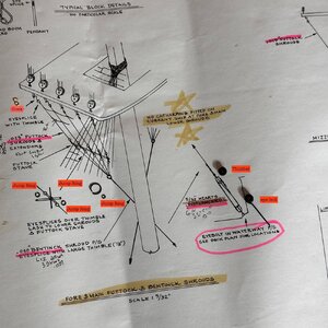

I have come up with my plan for the Futtock and Bentinck shrouds. I did not like the kit supplied parts so I made my own. I made the hooks, and jumps rings out of wire, instead of hearts, I opened up some thimbles and used them instead.
I can rig the futtock shrouds and the bentinck shrouds off the model. My connecting point will be the large jump ring. I will have two parts, on the top the futtock shrouds and on the bottom the bentinck shroud.
Each futtock shroud will have a hook, two small jump rings in the middle, and then a smaller jump ring on the end. There will be five of them on each side.
Each bentinck shroud will be attached to the waterway with a wire wrapped thimble with a lanyard in-between the two thimbles. The top end of the bentinck shroud will be seized to the large split ring. There will be two of them. One on each side of the model.
While on the model, the lower ends of each futtock shroud will be slipped on the large jump ring.
My final adjusting point will be the seizing at the bottom of the bentinck shroud. Once it has been adjusted it will be seized with diluted white glue like the rest of the seizings.
I hope this all makes sense. Now all I have to do is make 20 futtock shrouds and 4 bentinck shrouds for the fore and main mast.
