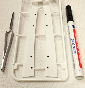

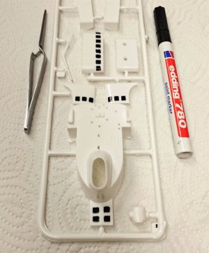

I did the windows with a fine, glossy black 'Edding' enamel paint pen. At night they would look glossy black anyway. Besides that there are no interior floors or walls inside of it anyway. I didn't trust cutting the windows out and then plastic glass wouldn't fit flush into the holes anyway. I decided to keep the kit 'traditional'.
Winch details A.jpgWinch details B.jpgWindows must be painted on.jpgPort holes on the sides.jpg

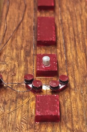

Here's how I improved the winches and deck details using some spare parts from N scale model train building kits.
Trawler winch.jpgGütermann Jeans Thread.jpgDeck detail from winch is poor.jpgHatch with ventilator and capstans.jpgR&H winches for trawler.jpg
I used 'Gütermann - Jeans Thread' for the winch because this color is mixed with streaks of steel blue and silver.
Plus I added some other parts.
I cut away the 'phoney' stuff on the deck using a single edged razor blade and added roller capstans.
My winch cables also now come nicely up front without hitting the hatch covers.
I also drilled the forecastle deck and bow for metal anchor chains or lines. But no photos of this yet.

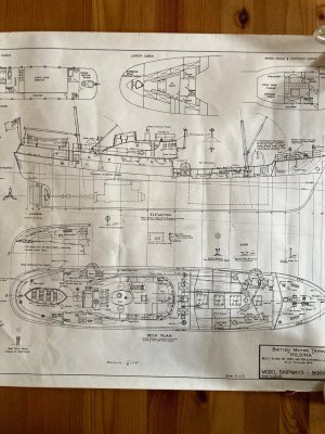

This kit seems to be based on the old Model Shipways solid wood hull kit of the British Motor Trawler "Hildina," which was built in 1951. The plans for that kit were drawn by H.S. Scott in 1954 for Model Shipways in 1:96 scale. Later, Pyro and then Lindberg marketed a plastic kit called "North Atlantic Fishing Trawler" that was a direct copy of the Model Shipways wood kit. From what I can see, the Pyro/Lindberg kit is of higher quality than the Revell kit. One defect in the P/L kit is that the masts were moulded with elliptical cross sections instead of the correct round shape. I assume that this made it easier to mold in plastic. When I built one, I fashioned round wood masts. Fair winds!
This is of course a nice trawler but has very little in common with Revell's 'Arctic Corsair' which is a lot longer and with a lot more HP. The superstructure on yours is also completely different.

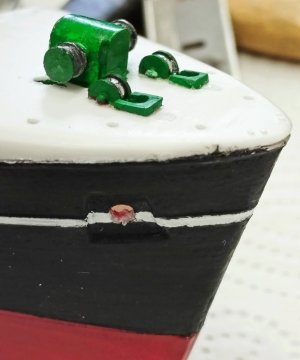

So now after another coat of 'Vallejo Model Color' black paint plus endless touch up work 'maybe' I'm now ready to apply the 'Kreul - Hobby Line' clear acrylic satin varnish over my black 'Vallejo Model Color' black.

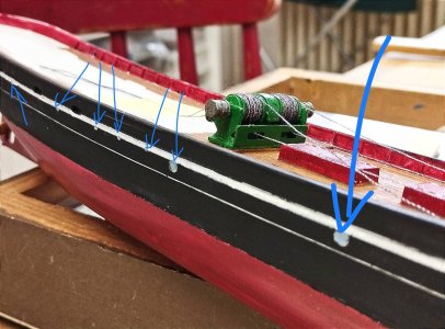

One problem were the 7 port holes on both sides of the ship. I painted them grey blue to simulate the refection of the sea or sky. But they are into the white stripe but some also extend a bit into the black which made painting my white stripe very difficult.
I painted my white stripe with 2 mm wide masking tape and an 'Edding' 780 series enamel paint marker with a 0.8 mm tip. And also with a 751 which has a wider tip. It coats well but dries poorly.
So maybe I'll oder some some 'Vallejo Model Color' white and paint over it. I'm 65 years old and my hand was more stable last year than it is now.

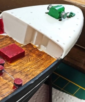

Another chore today was cutting a door into the forecastle bulkhead.
I did this with an old single edged razor blade and a lot of tapping with a small hammer.
I painted the inside of the forecastle red a meter high from the deck then white above that like on the 'Ross Tiger'. I also need to buy or make a stairway for on the port side. This is also where the 'Tiger's' anchor is stowed.
I had to drill the hull for an anchor chain hawse and also on her port side for the mooring line fairlead as there was no port side anchor on this ship. A piece of green carpet thread with a loop will make a nice mooring line to coil up by the winch.
The square part around my anchor chain holes in the deck still need their hinged covers when no chain or line is there. My winch add-on parts were extras from various N scale 'Faller' kits. (Extra stuff is always nice to have on hand and 'Faller' even sells extra sprues of parts reasonable on request if you live in Germany.)
This door also gives me access to rigging my anchor chain and mooring line and for service incase my anchor chain breaks. (For example: If one of my little granddaughters grab it!) So its good to consider every possible problem in advance!
