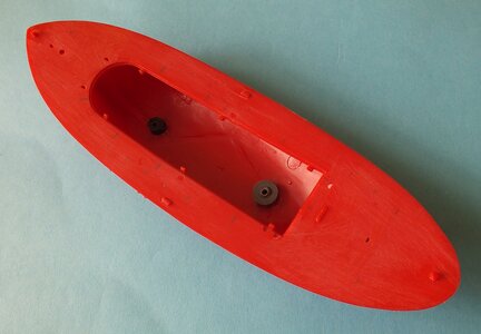

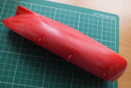

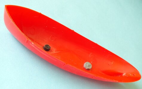

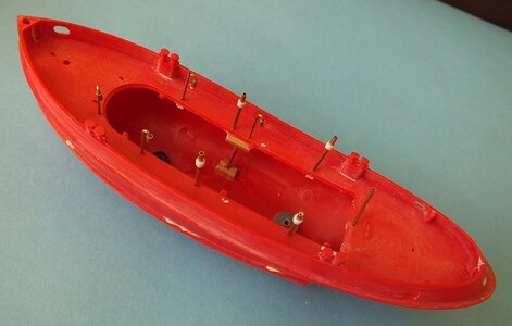

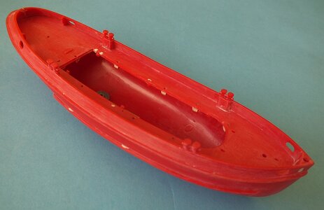

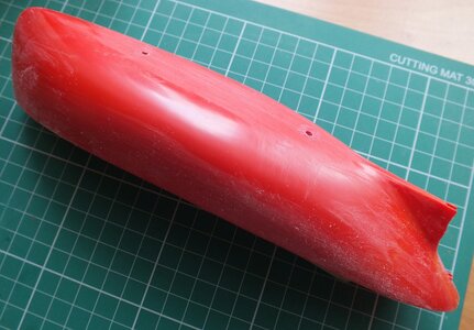

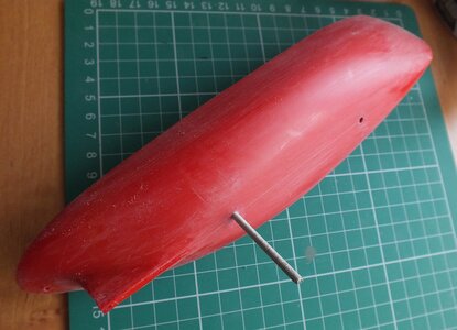

It is as old as the World model. Not the best quality but I could not find any other old plastic tugboat. I started with the hull. First I glued two pieces of plastic to the bottom of the hull which I then drilled and tapped. The holes will be used to fix the model to the base with threaded rods. The next step was to remove any unnecessary elements that the manufacturer placed on the hull and the deck. I will have to reconstruct them on my own. The pictures show what has been done so far.
I hope it is a good start...

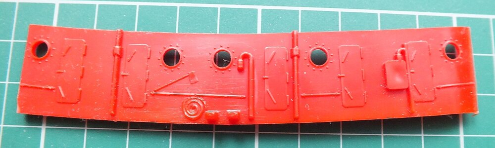

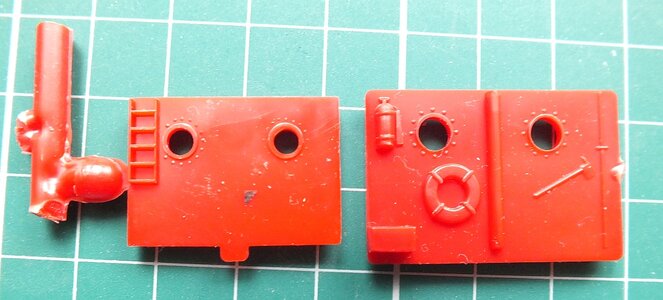

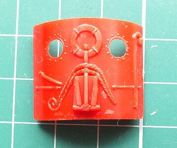

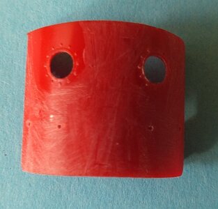

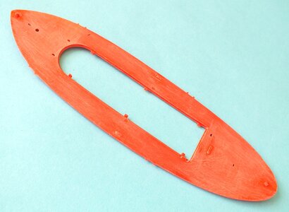

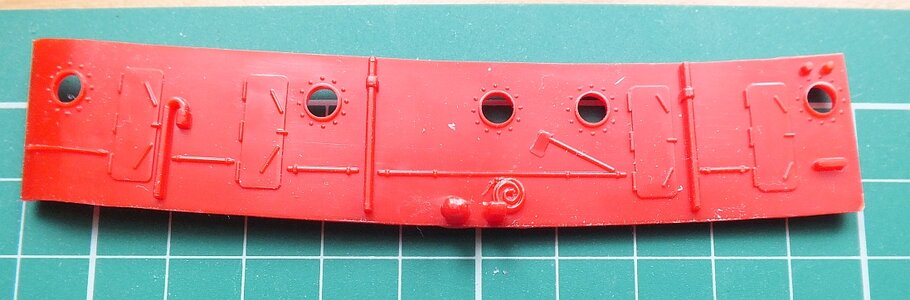

The next step is to clean the side walls of the superstructure of various lifebuoys, fire extinguishers, axes, anchors, etc... The scraped elements will have to be done on my own. I hope I will manage... After the scrapping work it looks like this...
Hi Will, I hope you will succesfully get back to modeling. Answering your questions the screws will be attached to the hull when the whole model, not only the hull, is finished. I usually use the "Contacta Liquid" glue produced by Revell Company. Sometimes Tamiya's "Extra Thin Cement" is in use.
Edmund, I have built the same kit. I like your idea of cleaning the cast in details off the deck and panels.

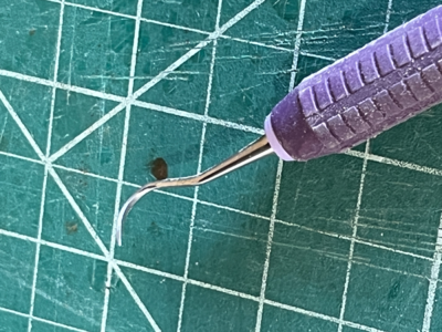

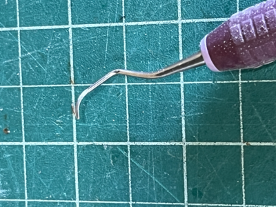

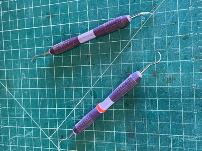

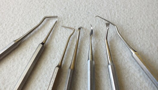

I found that using dental tools to clean up bi-metal casting and fittings worked very nicely. I have since started using them on plastic to hi light mold features.
My dentist gives me his used tools that he can't sharpen to his standards.
flat edged scraper
pointed tip scraper
These can be sharpened to keep an edge and they are free. Hope this is useful.

I had to remove the details from the deck and panels as they looked poor and unrealistic. I will have to redo them myself. I think it will look better.
As for the glues, that's right, test, test and test again. It brings the expected effect sooner or later.
As for dental tools. I confirm that they are very useful in the work and that is why I have a small collection of them:

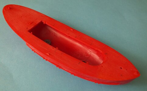

I have glued the deck to the hull:

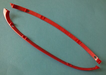

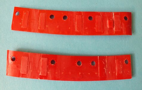

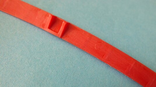

I removed the triangular "brackets" from the bulwarks, as they resembled everything but the brackets. The next step was to glue the bulwarks to the deck:

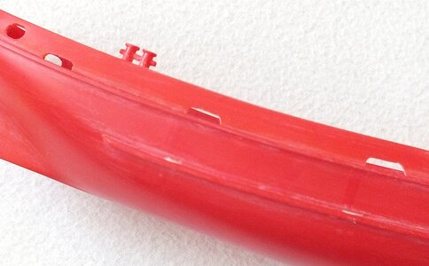

The next step is to cut the overflow holes in the bulwarks:
And that will be all for today. See you soon.

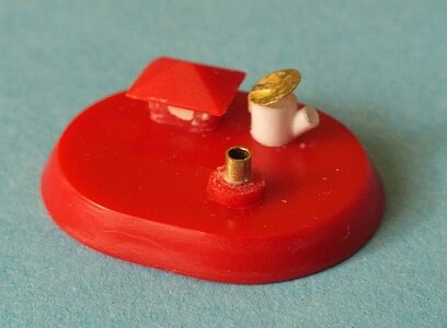

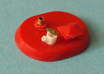

I made some supports and vents myself and checked to see if they fit to the deck. They look quite good. In my opinion of course:
Great Job in general cleaning up a less than satisfactory mould. Love the bracket removal from the bulwarks. The scuppers are great but might I suggest a few more as photos indicate 5 to 6 per side.
I included a zoomed area of tugboat bulwark stanchions and supports thinking you might want to consider something like this.
The vents are a great add. Keep up the great work.
Hi Will. Thank you for nice words. I have found in the internet some pics of harbour tugs with only three scuppers so I cut only three on each side. I am not sure now but I think that a scupper or two more will not look well.

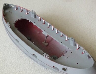

Today I am working on the bulwark supports. I think they would be better ones than the originals....
Best Regards

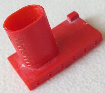

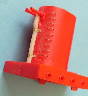

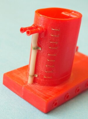

Back to the game. On the top of the funnel I made a new exhaust outlet out of plastic pipes and another tube of unknown use. I think it looks better than the plastic block suggested by the kit manufacturer:
I also decided to drill the aft platform, which seemed too flat to me. I think it gained some attractiveness after this operation:
I also attached the bulwark supports after painting the hull with a primer paint (Tamiya Spray Surface Primer):

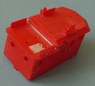

Hi Will and Jerry. I'm trying to do my best to get the tugboat model looking as good as possible. There is still some work ahead of me, but I am managing somehow. I have already glued the superstructures together. Now the glue is drying and I will take some photos when the conditions are better - now it is a bit cloudy and hard to take a good picture…

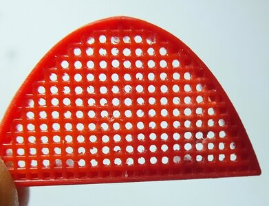

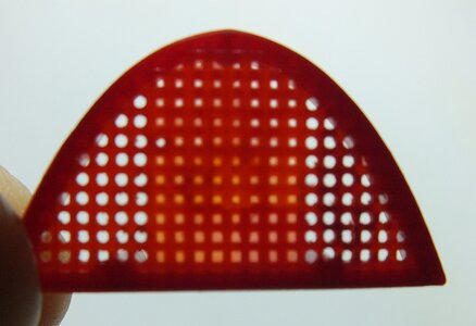

Hi Will. Thank you for your kind words. I hope the grating, when panted, will look well.

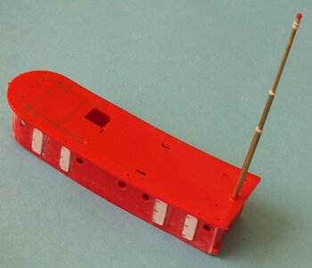

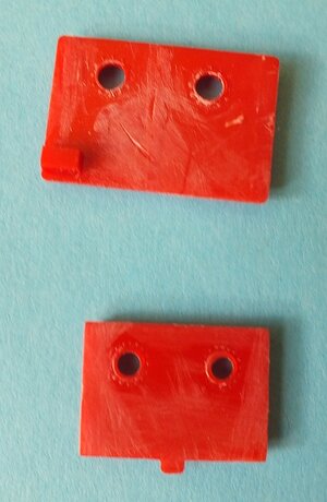

The sun shone a little and I was able to take some photos this afternoon. The superstructure panels came together nicely. I made a new hatch with an opening handle on the upper part. It looks like this:

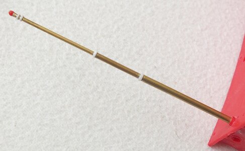

The lower part of the superstructure was armed with a mast. It was made of three brass tubes going into each other. The red top of the mast comes from the original mast of the kit. The rest was made myself. This is how it looks like:
Still the mast up close:

Edmund you are so bashful about your work. Ingenious use of brass tubing for the mast with the red tip. And you didn’t mention the side doors. Very nicely done.
