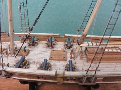

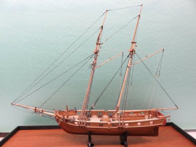

The Morris has now set sail and a couple of photos below show her mounted on the base. I could find no rigging plans for the Morris class of revenue cutters, so came up with a representative rigging scheme based on information for other schooners of the period (1830's). Lines were sized from contemporary rigging tables.
