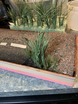

After looking at some shallow and deeper water marshes and plants I have decided to take mine from the dried out Autumn setting into a more lush and green growing early Summer by using some plant color green spray paint on the reeds, rushes and grass to mix with some actual small ones that I extracted and have clear spray coated with an acrylic to see how they are preserved. I will put a frame around the carved out foam base to form a dam the front so that I can approximate the amount of resin that I will need to use for the "water". Once that is known I can punch some holes to set the water reeds before the first resin layer is added. Plantings above the water will be set into holes with glue and then banked back with ground cover.

After using a plants green enamel the reeds and rushes are ready for planting below the resin waterline. After that is set I'll do an additional pour to fill up the front of the base frame and proceed to set the rest of the marsh plants with additional ground cover.Planting a Marsh.jpg

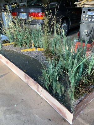

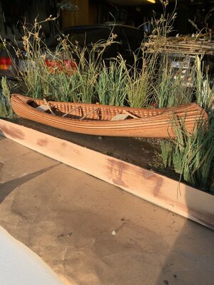

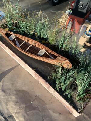

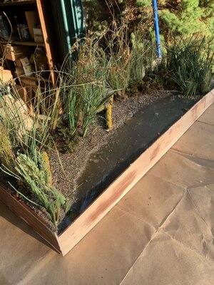

After two days of sanding surgery to remove flood of resin under and around the board I planted the marsh. Photos in front of my garage with the setting sun rapidly dropping down:
Three of the board and plantings at the water's edge. The four views with the canoe set in place as a trial run before dusk sets in. Still have to repair and refinish the fame and then try a focused set of photos with a black background.Planting a Marsh.jpgMarsh Board 10.9 A Planted.jpgMarsh Board 10.9 B SE view.jpgMarsh Board 10.9 C NW view.jpgMarsh Board 10.9 with canoe SE view.jpgMarsh Board 10.9 SE Lower view.jpgMarsh Board 10.9 wth canoe lower view SE.jpg

Really good looking diorama - great way of presentation

With the frame refinished I am looking for a board to place it upon and then encase the results in an 8"x10"x25" acrylic cover similar to the one for the previous 19" on the forest bank. Thanks for your reaction to the early just planted marsh with the canoe set in for a check. PT-2
