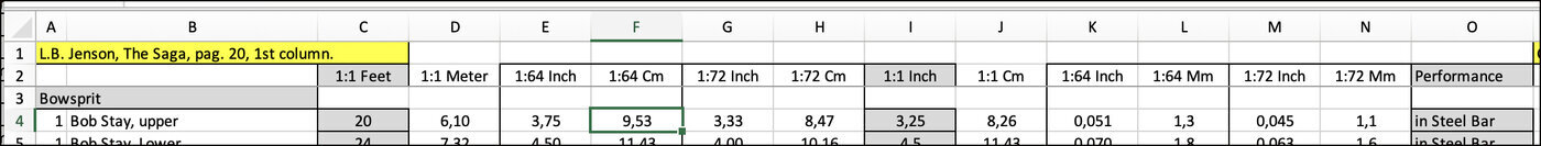

As mentioned in my build log of the BN, I was looking for the dimensions for the stays and lifts.
Not necessarily for the 'adsolute values' but for the dimensions in relation to each other.
L.B. Jenson has made an overview in The Saga on page 20 "Standing and Running Rigging Schedule & Block List".
Because I had put different values in an excel file, I processed the whole list right away. And will share it here.
I needed a magnifying glass to read the fine print. My Admiral couldn't resist taking a picture:
In the attached excel list I have included 3 tabs:
-Standing Rigging
-Running Rigging
-Blocklist
Explanation of the structure:
Standing Rigging tab:
In the columns:
A/B: Amount+Name of the line
C: (length) and I (diameter) the values stated by Jenson in Feet and Inch, O = explanation
D and J: Converted to 1:1 in meters
E+F and K+L: Converted to 1:64 inch+cm/mm
G+H and M+N: Converted to 1:72 inch+cm/mm

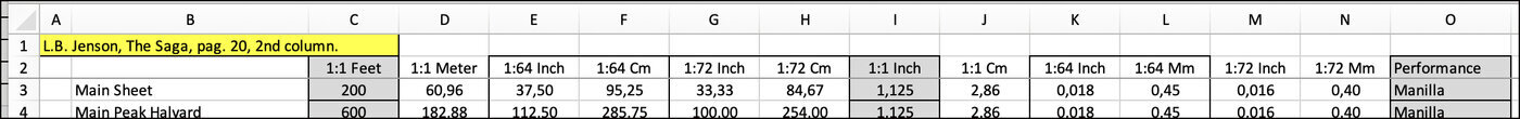

Running Rigging tab: (Jenson only for now)
Similar columns to Standing rigging
Blocks tab: (Jenson only for now)
A/B: Name of the block
C: specification
D: amount of blocks
E: type of block
F: The value reported by Jenson
G: Converted to 1:1 cm
H+I: Converted to 1:64 inch+mm
J+K: Converted to 1:72 inch+mm
L: further specification of the block type

As mentioned in my build-log, there were some big differences between the values of Jenson and Lankford.
For confirmation of 1 of the 2, I started looking in Chapelle. And found a list of the Getrude L. Thebaud. With the comment: "Circumference".
Made a up-date of my excel-sheet with:
-added a tab with the Chapelle's values with extra column for circumference and for diameter with the divided value by pi / 3.14;
-added new 'Chapel' columns in the other tabs.
I have still not all the values from Chapelle, because he uses a lot of different names for a bunch of ropes.
Then I assumed that Jenson may also have used 'circumference' in his rigging values.
All Jenson's values divided by pi and then a lot of values were pretty equal.
