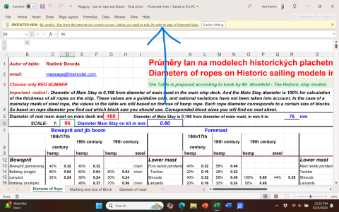

I've found this to be a great help. You just have to find the ship of the right number of guns/tonnage. I think that even if you are not working with an English ship the relationship between various bits of rigging would be the same. You will have to learn the names of the rigging bits though.
The link takes you to the 280-300 ton pages but you can work your way to larger ships from there. There is also a ton of other info in here.
