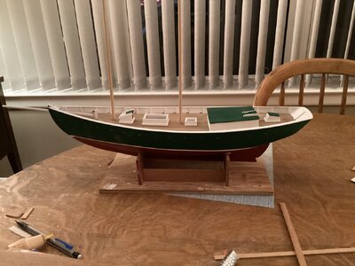

I am in the process of rigging a scratch model of a Newfoundland banking schooler in the class of a “western boat”, but I am confused as to the attachment of the shrouds at the top of the mast. Two shrouds bend around the mast at the cross trees or spreaders and I am not sure about the third. I think that the third goes to the mast head and it should lead. Through the end of the aft spreader but this does not lead through in a straight line. Chapelle is not clear on this. Can I get some feedback on this.

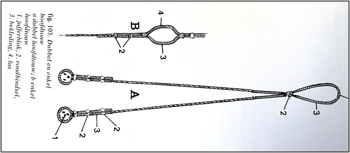

Hi Robert. Nice to see the scratch build of your schooner. About your shrouds question: I suppose its about the shrouds around the top if the lower masts?
If there is a uneven amount of shrouds, the single uneven one is often served as a ‘swifter’:
The text is in Dutch, it’s the top one noticed as ‘B’.
It’s this what you mean?
The text is in Dutch, it’s the top one noticed as ‘a’.
That is what I was describing. :)
