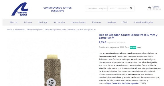

The smallest rope I can make is 0.18mm using Skala 360 thread.
You will find that most manufacturers will claim to have 0.1mm or 0.15mm ropes but I've measured quite a few and none come close. For example that Artisania Latina "0.15mm rope" measures in at around 0.45mm.
