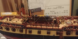

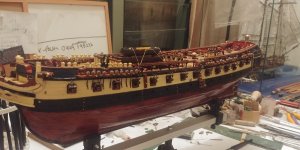

Love ya work. So on that theory as all masts and yards are built with sails and all rigging off ship do you then start from the bottom sail and tie off as you go then work up the ship
After the 3 masts are on ship and standard rigging done is this correct on what i read
Cheers snowy
Ps as my first ship with 21 sails and crowsnest× 3 cheers
Ok maybe badly written

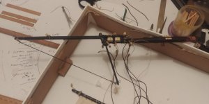

1 all masts and yards with all rigging built off ship

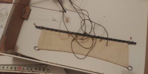

2 put sails on yards with all rigging fixed
3 then put masts on ship with standard rigging
4 add yards with sails
5work from bottom to top with sail rigging and all other rigging

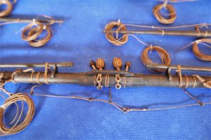

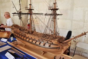

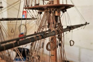

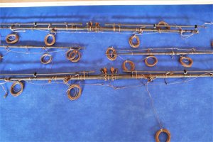

Absolutely the best written explanation I have seen on this subject. I like to do as much as possible off the ship. I usually rig all my blocks to the masts and yards Prior to installing them
Unreal donnie and uwek
