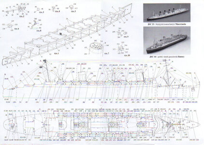

My Vasa is finished, more or less, can't start with the seascape and can't fix my leaky bathroom right now, so I start my next model.
Now, there is this paper model of the Queen Mary but I won't build it though, cause at scale 1:400, it will become a 77 cm monster. Where would I put it? :rolleyes:
So I copied it down to 30%, meaning scale 1:1250

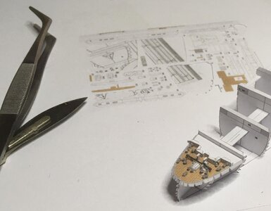

Don't be fooled by the scissors. I don't use it, it would bend my paper. All lancet knife cutting and (with the back) grooving (is that the correct word?).
I have done this once before, so I am confident I will succeed in the end.

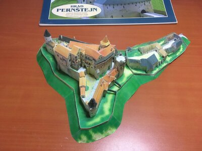

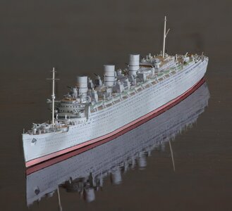

This is Hrad Pernstejn. Original 1:300, but I copied it to 40%, so I made it at 1:750.

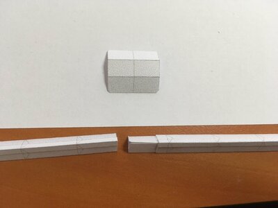

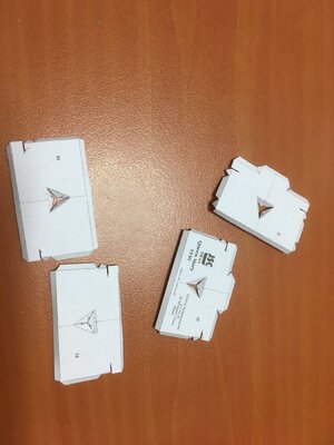

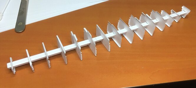

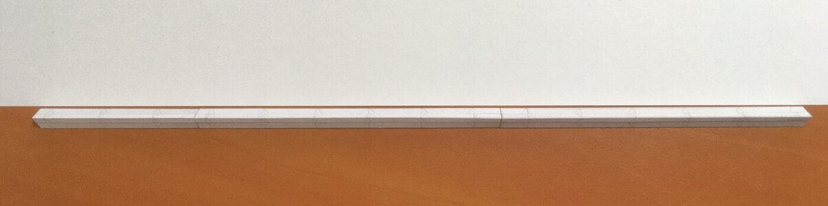

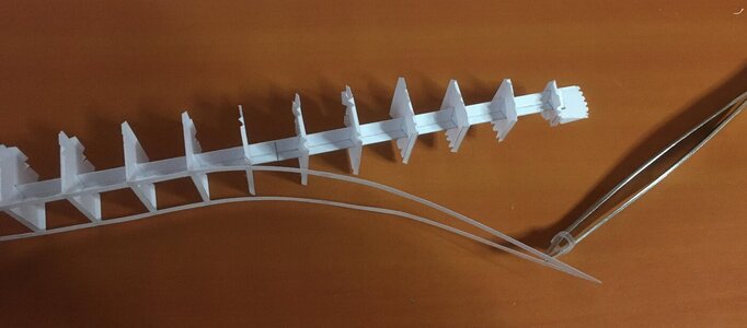

So there I go. First the central triangular tube.
The connectors where too broad and wouldn't go into the tube, so had to remake those a tiny little bit narrower.
And that is the first part; straight and without torsion:
I use acetone based hobby glue btw. No wetting the paper, and I put in some extra acetone to make it thinner.

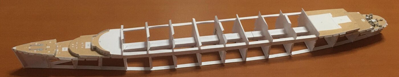

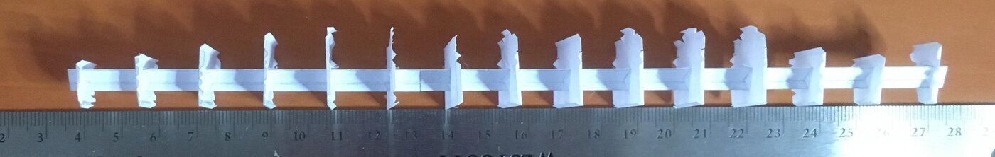

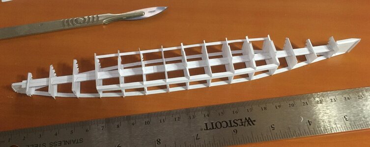

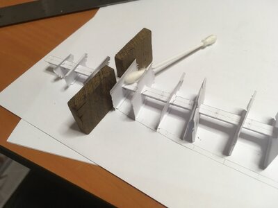

Next stage. I am going much faster than intended. Hmm. Cautious
The holes in the frames are just not large enough, so I enlarged them on the top site. Perhaps a little too much, but that doesn't matter.

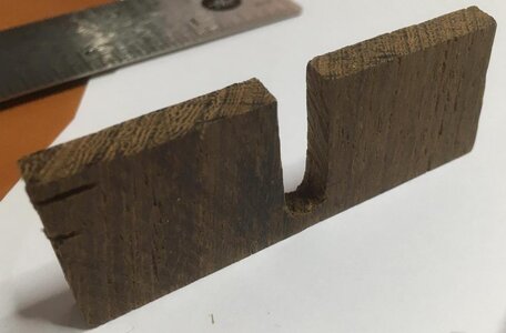

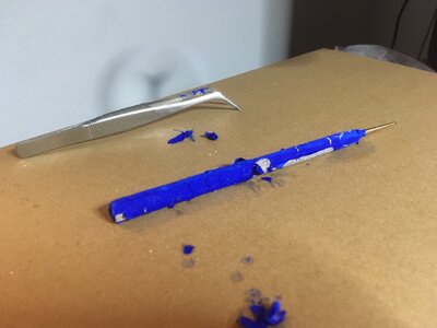

Next I glued them to the tube but only to the lower flaps, while applying a little pressure using that nifty tool I made from panga panga wood to keep them perpendicular.
Result: All frames touch the table. Not perfect, but I think good enough.

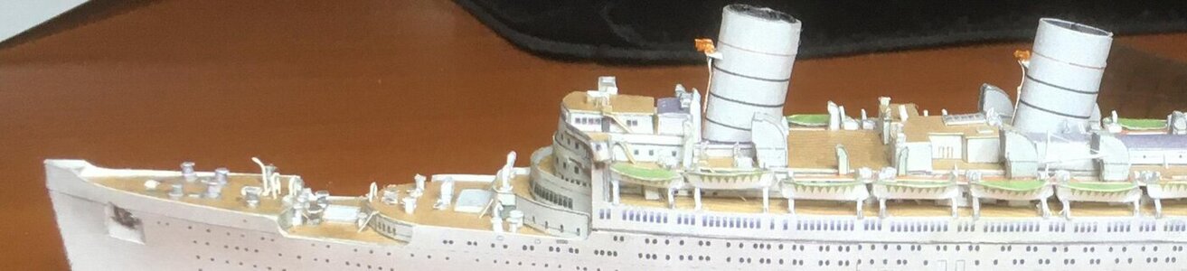

Well, I started it, so I go along with it.

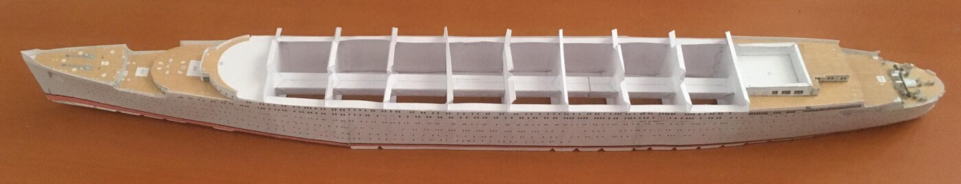

Adding walls and decks;
Slap the sides against it.
Yep, I turned it gray. I'll make it the WW2 troopship version. A bit too light, but real battleship grey is much too dark for such a tiny model.
And more stuff;

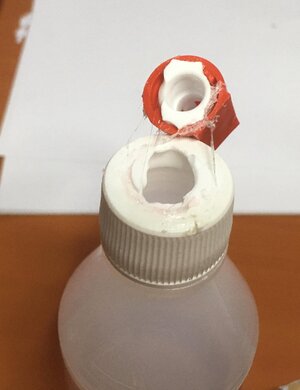

And then the glue bottle broke. :rolleyes: That does it for today.

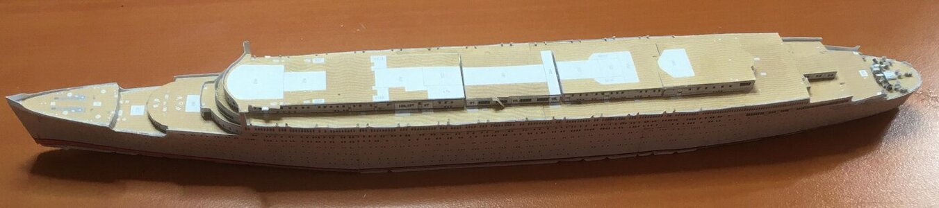

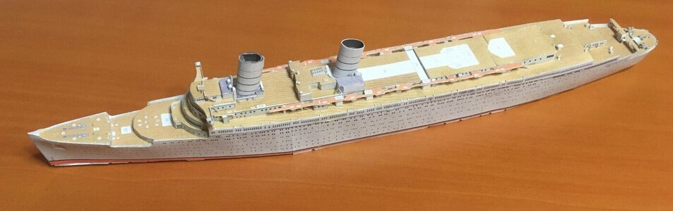

An update to keep me motivated.
Most important development; I bought a new bottle of glue.

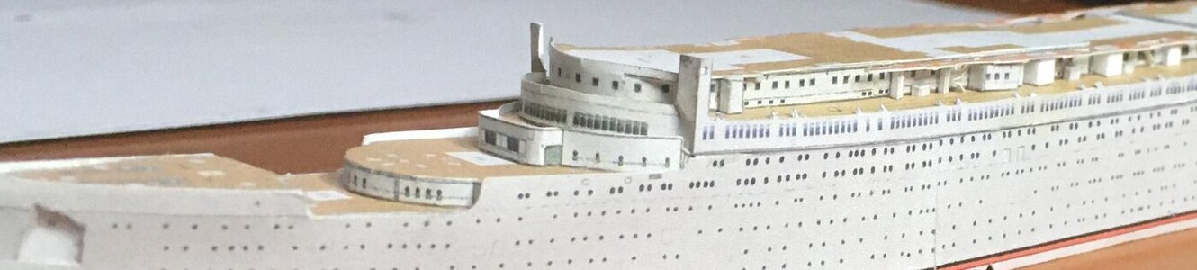

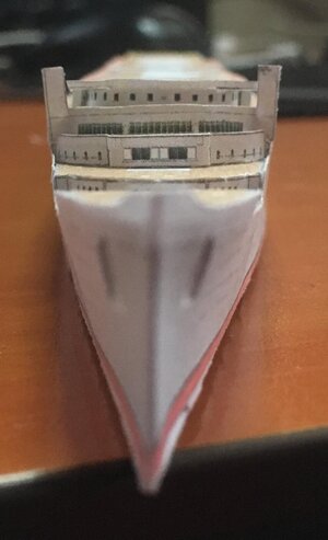

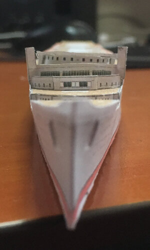

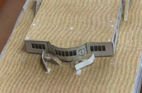

Now, I think I noticed people think you cannot correct when building in paper, but that is incorrect.
When doing the bridge I wasn't paying attention it seems, for after the glue dried it appeared the bridge was skewed.
Now I forgot to take a picture before, so I edited the picture after the correction to show how it approximately was.
Before (edited): _____________________________ After:
It is very simple; just apply acetone gently with a brush until things start moving under a little pressure. Keep it there untill the acetone has evaporated.
Now you cán drop your brush into the bottle of acetone. Really, I did, so it can be done.
But after careful analysis and making deductions I came to the conclusion that doing so offers no advantages whatsoever.

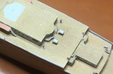

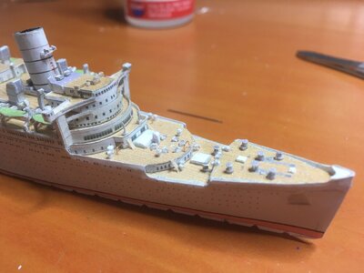

Now there are a lot of tiny fiddly things to add to the ship.
Here is one, a little bit of deck with a stair:
It can't be called building, or even crafting. It is just only nudging everything in place!

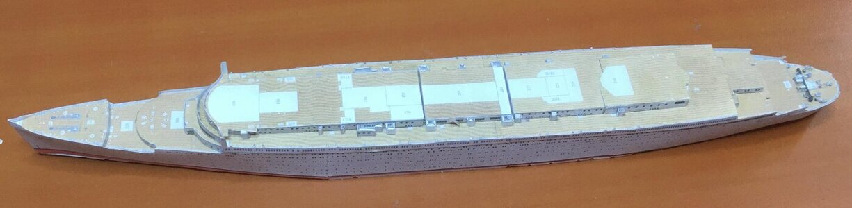

But, I soldier on! This is what I have now. It looks like I have made progress, however, I am now only exactly halfway down the instructions..... :oops:

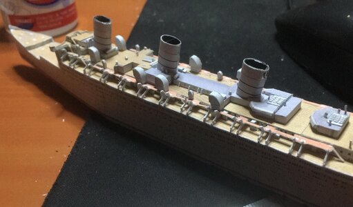

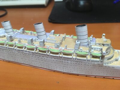

I can't say I am procrastinating. :)

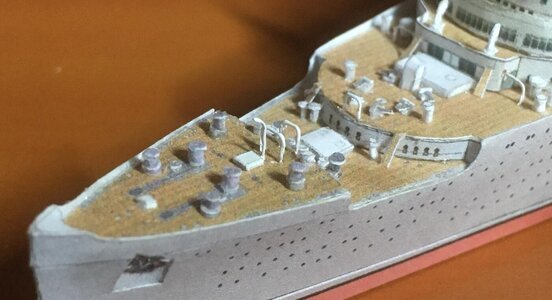

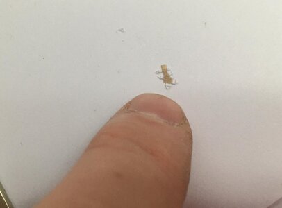

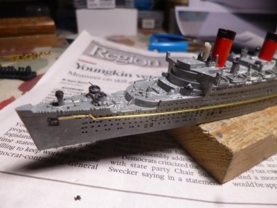

Put on the davits. That's a lot of work. Even after redesigning them so that they consist of 1 part (in 4 layers of paper) instead of 6.
The lifeboats were, quite unexpectedly, not that difficult to do though.

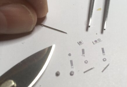

Just to show the insanity; I need a needle to shape the parts of the bollards.
IMG_1450.JPGBut they came out nicely :p:
The stands and horn hoses are made of copper wire.
IMG_1454.JPG ... and then painted white.

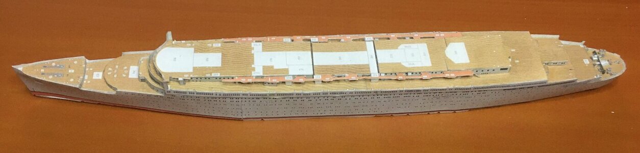

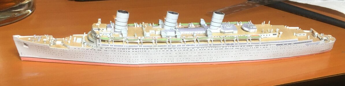

This is her current state:
Now next I have to make the changes for the troopship version.
That means creating 40(!) gun (and missile and director) positions with 35 barrels pointing upwards. The QM was better armed than the average air defense cruiser.
Have to design them from scratch first though.
Also 10 extra lifeboats, a radar post, and degaussing coils (against magnetic mines).
I read in one source she even carried torpedo's. :) Can't find a picture of them regrettably. They should rest on a ledge astern, just above the waterline.
After that I will add the masts and some rigging. And then I want to make a seascape of course.

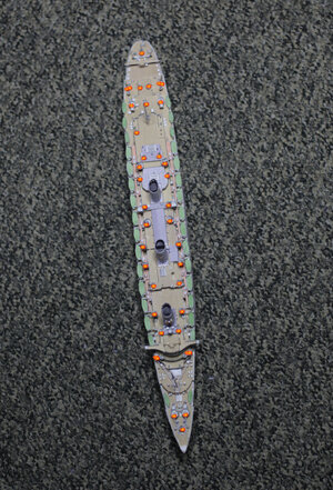

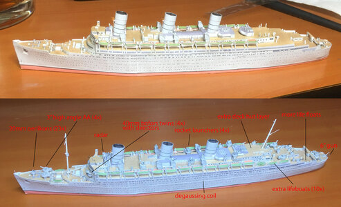

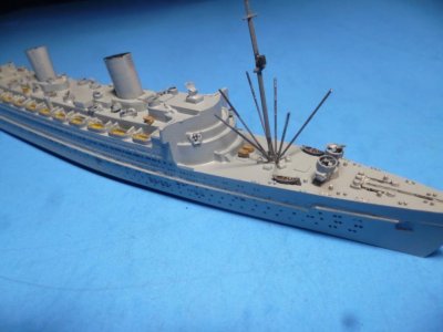

Here are the promised changes for the troopship version. And I did the masts.
Had to build from scratch an extra deck hut also.
The masts are really parallel to each other. Drat that perspective!
There is a lot of AA on the deck. Image you in a german bomber, and they are all shooting at you: :p
Well, it never happened. The QM was never bombed, but they did shoot on any plane getting near, whether friend or foe! They won't take risks.
And a HF image (12x) for good measure:
