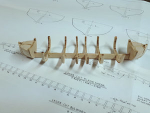

I thought it would be fun to build a simple model for a change (and avoid all that rigging.) This boat is very attractive and I think it will make a handsome little model. I located it at Cornwall Model boats and it was quite inexpensive.
It would seem on the surface that such a kit should be considerably easier to build than a large intricate one, but already I'm not so sure. I know I would be up the creek already if this was my first "starter" kit. The instructions are weak and the illustrations are pretty poor too.
There are a couple of ridiculous "stiffeners" as they call them to be installed at the bow and stern, but I soon discovered they are all but useless, so I cut them out and added filler blocks. I'm a little concerned about the planking. It's clinker, which I've never done before and the material provided is 1.5 mm thick which seems like it will be very heavy to bend over the short length of the model. I'm considering substituting 1mm planks, but I'm not sure if the scale would be noticeably off. I will do some experimentation.
My fears may be premature, but I suspect I'm in for a bit more of a challenge that I anticipated when I bought this one.

Well, I'm just about ready to throw this thing across the room. I have made four attempts to plank it, never getting more than three planks on and then dissolving the glue and starting over.
I was hoping it would be a little in-between project bringing me nothing but joy:), but it is the most aggravating difficult thing I've tried to do out of all the models I've built. There are many problems to solve: the bow and stern are identical, so if I try to use one plank for the whole length, it has to be cut and fitted perfectly at each end, rather than fitting it only at the bow and just cutting it off at the stern - the planks overlap, so it's very difficult to figure out how much to taper each one at the ends - I don't know what the planking wood is, but it's very hard, very thick and is too heavy and inflexible to work with against the weak and flimsy framework. If this hull was about 24" long with sold bulkheads it might be ok but as it is it's like framing a wall with 2x2's and trying to nail 2x4's on as the siding - and last, but far from least I simply cannot get this clinker planking to blend from the overlap into a flush fit at the bow and stern without looking like hell.
As you have probably inferred by now, I am not having fun with this one, so it's going to have an indefinite time-out and I'm going to focus on my Pride of Baltimore. At least I didn't spend much money on it.

Hello David. I might be too late, and the small boat model become a plane landed across the room, but... if clinker created too much trouble, try to plank carvel instead. In the end, it is your model and you govern how to make it!

Jim, You are in time; it hasn't flown across the room yet. Thank you for that idea. No one would really know the difference, would they, and I have plenty of thinner planking material hanging around. That just might be the answer.

I know, I'm now failing to understand why so many people recommend these small kits to first time builders. I think they'd be much better off with something a bigger. I started with the Armed Virginia Sloop and I think it's an ideal starter kit, with a little bit of everything to do and you don't have to fight with the design of the kit.
The problem for me is that the planking is too heavy for the short length of the boat and it is almost impossible to bend it and secure it without it looking terrible. The clinker aspect is another challenge, largely in part because you have to work from the bottom up and it pretty much rules out working in belts. I've decided to plank the hull as I normally do with some 1/16" x 3/32" basswood that I have and if I'm happy enough with the look, I might leave it at that, or I might attempt a second layer clinker style with very thin material. I think it should be easier with thinner material over a smoothly planked hull.
It hadn't dawned on me until I started working on this one that the boat "Chasseur" for my Pride of Baltimore II is planked clinker style, and I'm more interested in doing that one correctly, so practice on this model, even if it becomes a sacrificial one will likely prove worthwhile in the end.
