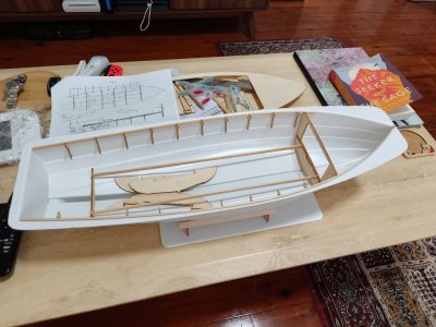

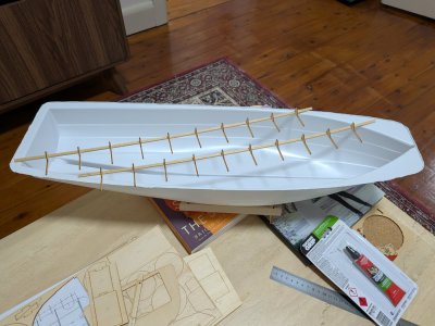

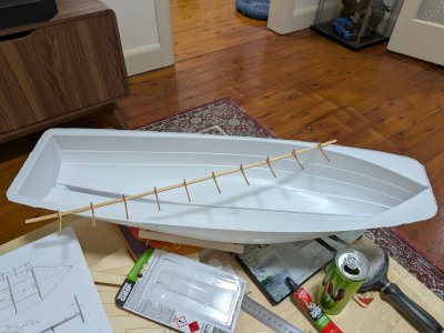

The first part I made was the wooden boat holder, where I used a metal ruler to measure the required lengths of wood before cutting it with a rotary tool. I admittedly didn't cut it too straight, and had to sand it flat, but it turned out pretty good! I used Tarzan's Grip super glue to hold the pieces together.
I then turned my attention to the ABS hull, trimming the vertical lip off the top using the rotary tool. I still need to sand this to clean it up, but it's good enough for now.

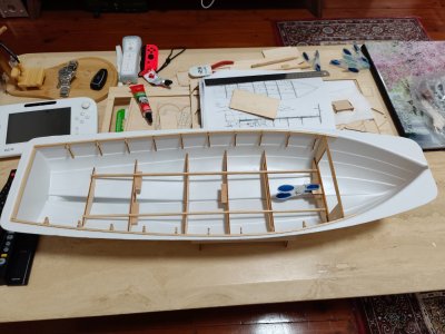

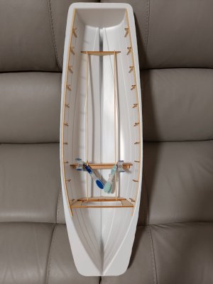

Next up, I measured where the front-most "wall" (?) is meant to be from the very front of the hull and marked that on the hull. This gave me a reference point for all the wooden "ribs", allowing me to measure and mark them up. To cut out the notches for the ribs, I used a hobby knife which worked a treat.
This is where I left off today, having glued each rib to the length of wood. The next step is to glue the lengths of wood to the hull.
It's slowly coming together! :)

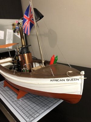

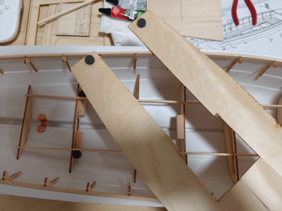

I only get to work on my AQ kit when we are away from our Brooklyn apartment and in our Kingston area country house, so I’m into my third year on this build. I strongly suggest that you go to the Billings internet site where there is a photo build of the kit by an expert modeler you can access that is on the AQ page. A key is to leave the kerf (selvage?) on the tip of the hull until the deck is fastened to it later in the build. The printed instructions do not guide you on this point and I am at the point where I am about to put down the deck with much less to support it because I removed the kerf as a first step in following what a supplemental instruction page appeared to require. I still cannot figure out how the deck is basically flat but the bulkhead that attaches to underneath is rounded on top. Any builders have help here?
