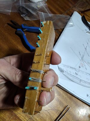

I've been fighting with rope hanks, trying all of the You Tube methods and ending up with tangles. I was laying awake last night and it popped into my head. I use heat to stop rope from unwinding when I take it off the rope walk. Why not put my loaded hank jig in the oven, maybe it will lay right afterwards. It does!! 5 mins at 325f and the hanks are the perfect shape and don't sproing. Minimum glue is needed because the thread has taken a set so there is no strain on the glue. You can even put it in the oven with wet glue and in the 5 min the glue is set. They are maybe a little too perfect as they all look the same but I'll work on that. One caveat, I think it will only work with polyester rope. But the sproings and tangles are gone :)

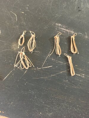

making coils can be a real pita. my problem is size. ive got to make mine smaller but its so hard as it is to jig m up never mind making the loop... thats were the challenge begins. im working with the sharpest forceps in the surgical catalogs. when looping the loop is when everything goes crazy. my coils have to be finished 5/32" at most or they are laying on deck. my jig now has been reduced to 2 hemming pins. i wet my thread so it stays managable n dries neatly. but that last step screws me everytime. the coil picks up n the fun begins. the few finished ones i did get are then given a soak of thinned glue to hold their shape. id say 1 out of 5 tries makes it to the model.
ps im using cotton
